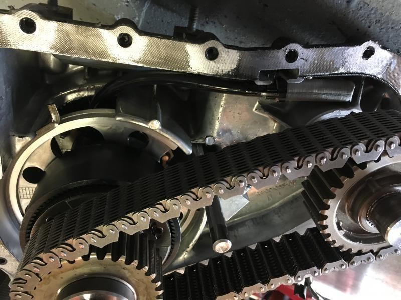

Hello all, Have a 2001 ML320 that I bought four years ago that I am second owner.. When I purchased i could have sworn the guy told be he just change transfer case oil. Fast forward to now as I started getting a clicking noise low speeds while under acceleration especially in a turn. In doing some digging folks have said transfer case has a chain and could be loose causing issue. Have vehicle at local indy shop and he ruled out half shafts and carrier bearing. He stated sounds like it's coming from transfer case. Question can transfer case be rebuilt? Or should I find a used or rebuilt one worh low miles? Also could a gear oil change fix problem? Thanks for feedback

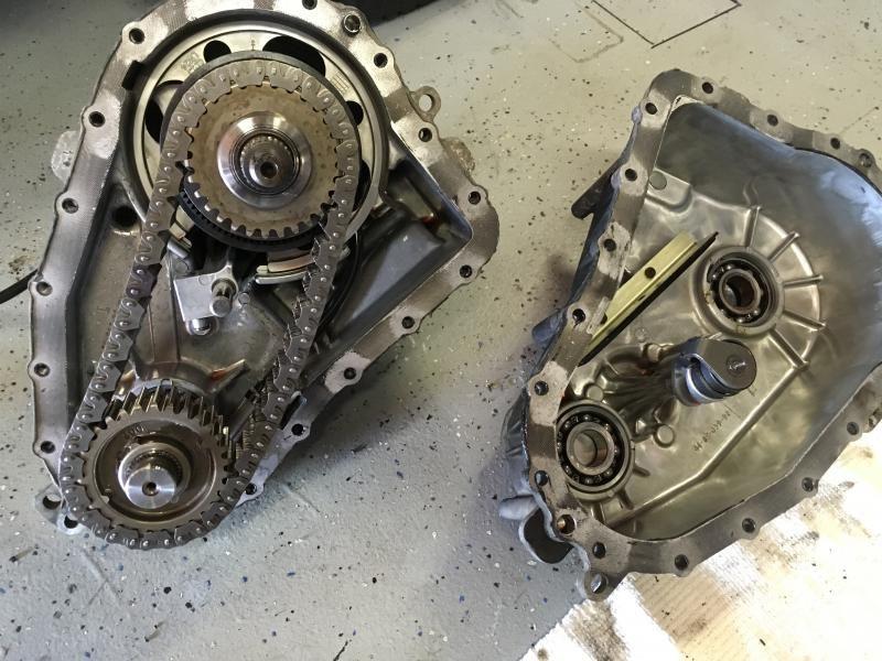

Hi, Till a couple of years ago I had ML270 2002 and I can confirm that within the transfer case there is a chain. How do I know that you ask. Well one sunny day going up the hill my transfer case fell to bits and the chain was sun baking on the road. I didn't re-build but bought a second hand one in a good nick. To my knowledge there are kits for re-building the transmision which include new chain. You didn't mention if you had checked level of oil in the traney. I would do that first.

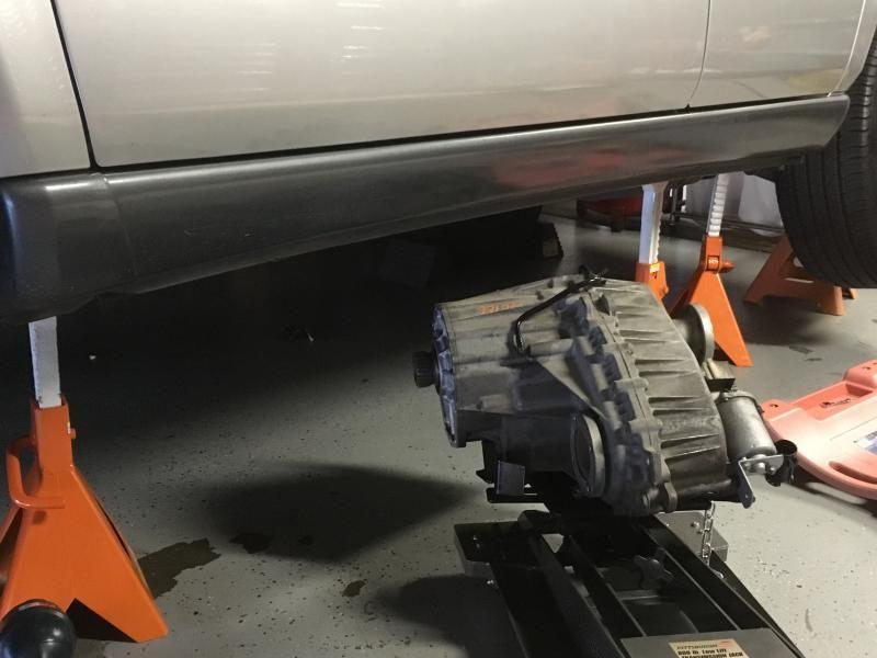

They're not difficult to change out if you have a full day and some tools.
