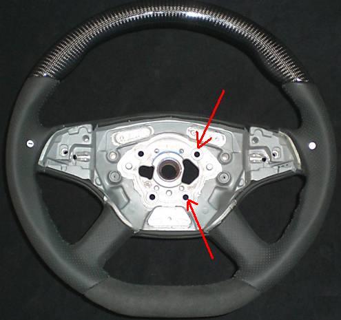

anyone knows if 2009/2010 ML350/ML63 AMG steering wheels(with matching airbags) can be used to replace my 2008 pre facelift one?
i notice the 4 holes around the central hole of the wheel base is different between 08 and 09 model, what are these holes for?
** attached pictures below.**
thinking to get one with ergonomic desgin. please help, thanks!!

2.jpg - 09/10 steering wheel base
3.jpg - 08 steering wheel base
Attached Thumbnails Retrofit 2008 ML350 Steering Wheel-2.jpg   Retrofit 2008 ML350 Steering Wheel-3.jpg

Yes, it will fit. Now about the buttons working....thats another story. Be sure to have the power completely cut off on the vehicle when working with the airbag.

thanks Veloc! oh there is buttons control!! any idea how to get the buttons work? or a workshop with STAR sys should be able to configure it without adding extra component?
or somthing to do with fitting an 'in-wheel control module' for the button control? If so where can we get this?
and could advise what those holes in my 2nd post for?
