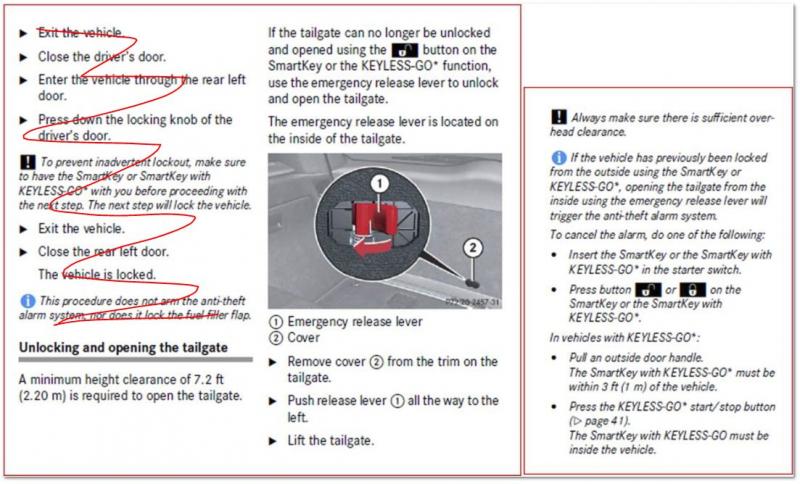

Could be a problem with the motor that pulls the hatch fully shut. Not uncommon.
You can open it manually:
