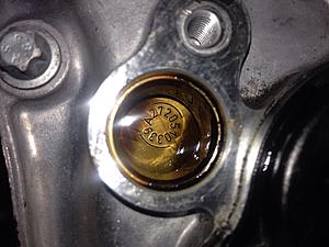

Hey everyone new to this forum.. Just had a CEL on with code P0016/P0017
From what I been gathering on this forum is to take sensors out and crank pulley to TDC and check if the 2 circles if it aligns in the middle .
My sensor A side is perfectly align in the middle but the sensor B side is abit off
So I guess I'm gonna need a repair on it soon
I'm in vancouver BC canada just wondering if anyone had the BS done and know the cost for it .
2006 ML350
98,000km
Thank you everyone hope someone can help
Attached Thumbnails Bad Balance shaft P0016/P0017-image.jpg
