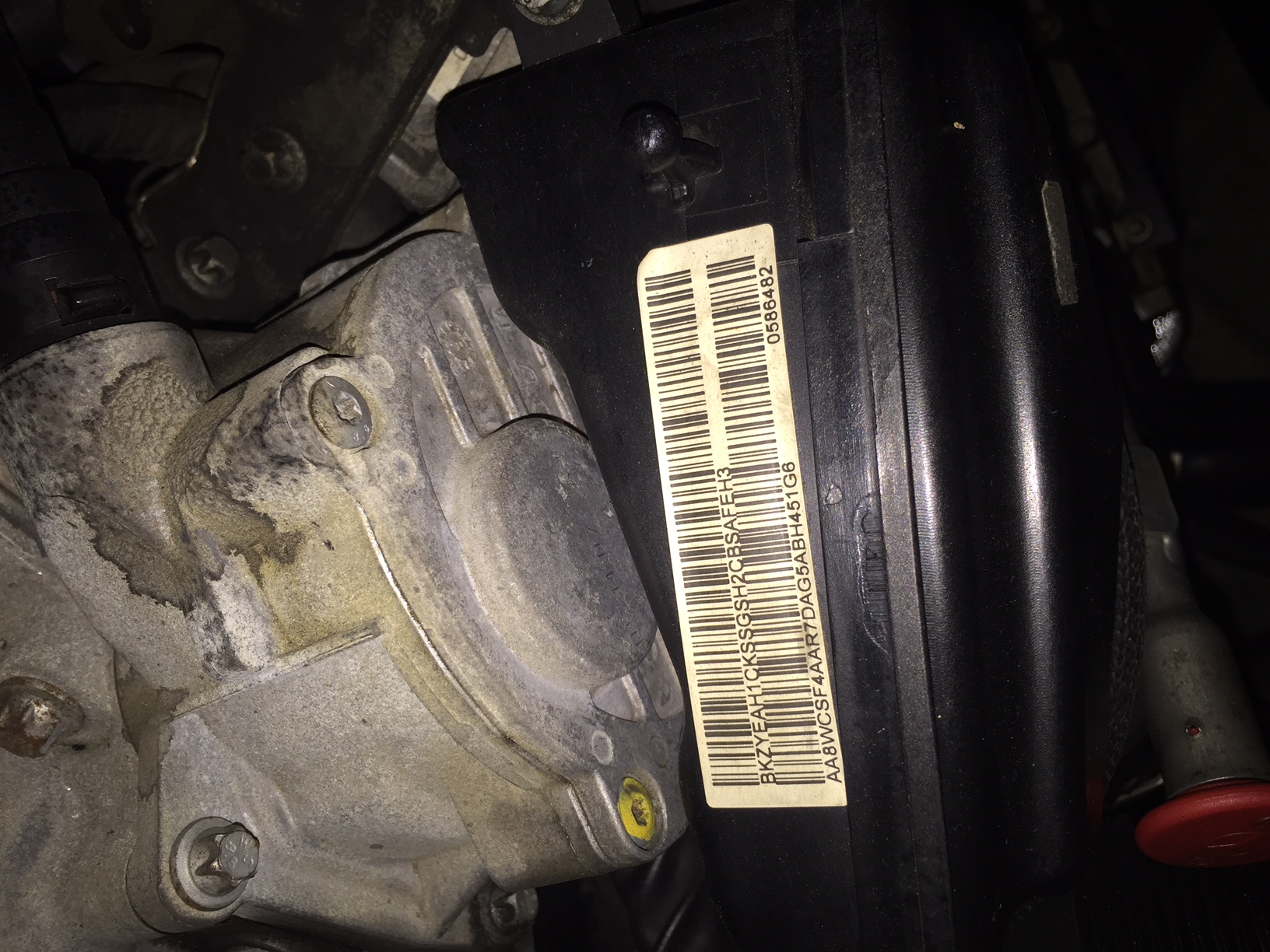

found the source
ok, so I found the source of the sound and its this black box located in the picture.
I just need the name of this box and its contents.
Does anyone know?
Ive been searching online for the numbers and I cant seem to find anything.
Thank you !!

I second that. All very normal. The black box is the glow plug control module, but behind it is the air intake mixer ducts where the EGR stuff meets the intake air.
