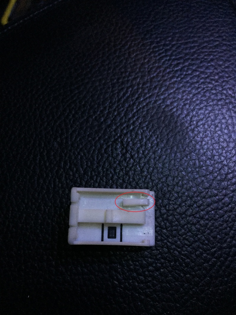

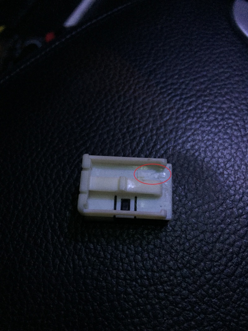

As the cable was designed to use the factory AUX input you'll need to break off the tab (circled in red) to allow for it to fit into the slot for the RSE input.

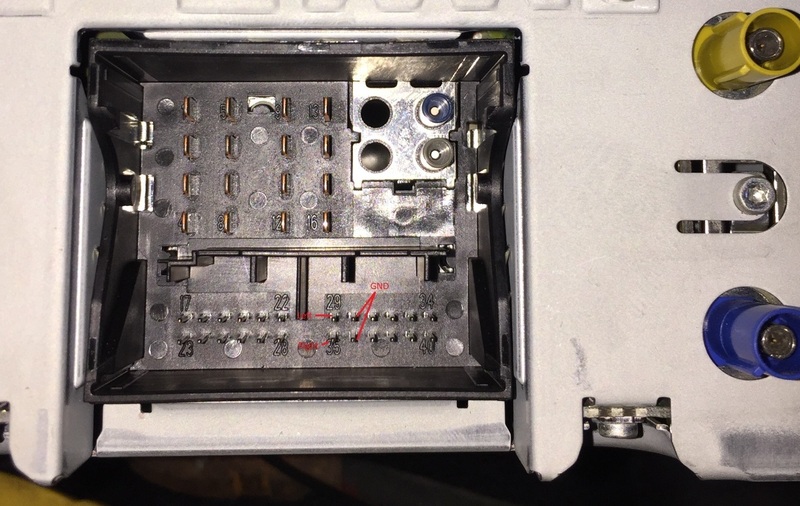

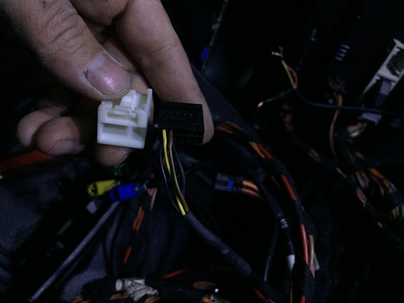

Then you'll need to undo the pins from the AUX cable, and re-insert them accordingly:
29 - Left
30 - GND
35 - Right
36 - GND
Refit everything back together, now when you select RSE, you will have an AUX input.
