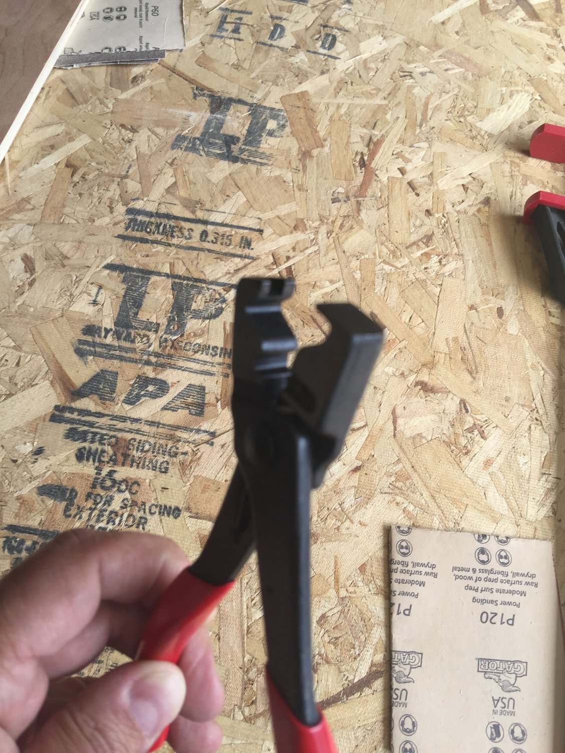

Thanks jkaetz. Replaced the sensor today. I have the tool for these clamps, so it wasn't too complicated to do the job. Air filter housing needs to be removed though. Error codes are cleared, test drive went ok, fingers crossed this resolves the issue. Here are some pics:
