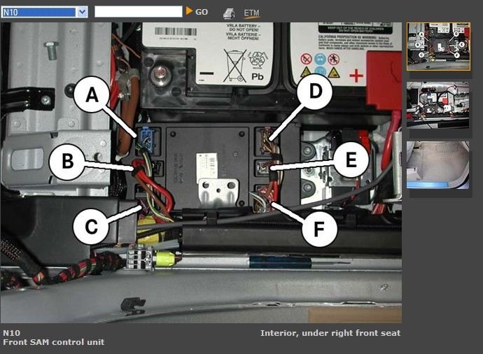

Here is a wiring diagram from Mitchell. Check the fuse. Check the front SAM for any water entry.
You are probably using AUTO on headlamps, but what happens if you turned it off and then turned on the parking lamps? Your problem could be with the Combination Sw. on the steering column. Test it in different ways.
