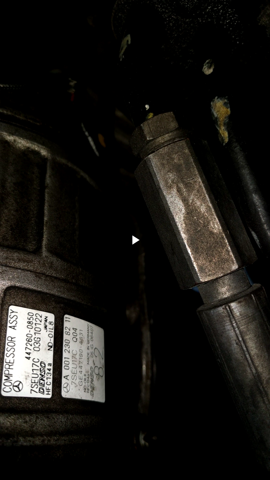

Question How to choose correct A/C hvac compressor
How do one choose the correct A/C compressor for the car? Mechanic told me that mine needs to be replaced and quoted me $1500 includes dryer (Filter), expansion valve and freon + labor.
I've looked at the geekparts, autozone, rockauto website but there is a lot of them, some look like exact fit but cheap $189 and some are expensive $400, some have a clutch and some do not.
The one I currently have is Denso 7SEU17C, HFC134a, ND-OIL. Check attachment for screenshot. I cannot tell if my has a clutch. Can I install with or without the clutch?

Your 82 11 compressor has been replaced by another. Search for that number.
As of 2002 MLs do not have clutches.
