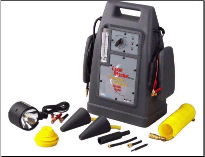

Thinking of smoking the car and seeing if there are any vacuum leaks.

I had the car smoked and found no leaks.

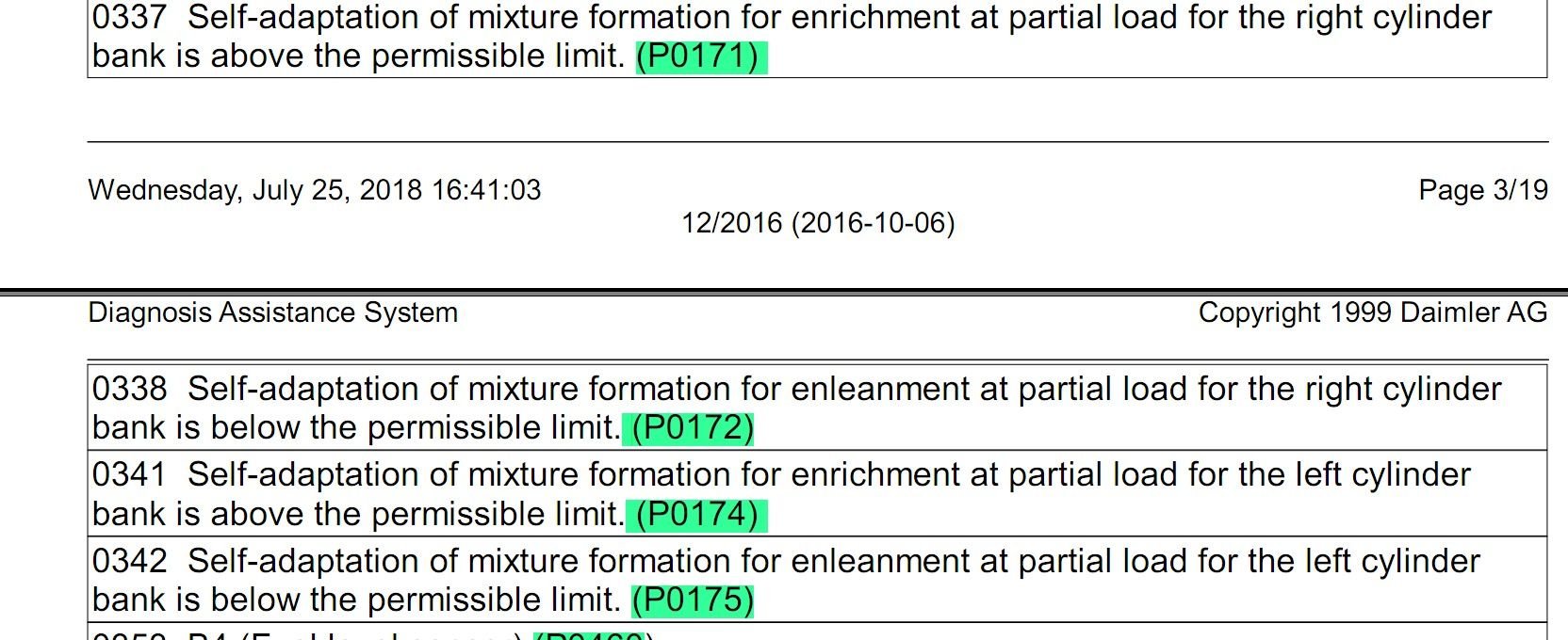

Chris, every component has its own code assigned to it. Don't start replacing things because you think it could be faulty.
Look at the description of the codes, then look at the explanation and possibilities of the codes. What is at the top of the list of possibilities?

Thanks for the help so far. - If I'm reading this correctly (which I'm new to all of this so bear with me) my issue is "unmetered air" - if that's the case how do I diagnose the problem? My ODB 2 meter is only giving me the P0172 and P0174 error codes - Or is this suggestion that my issue is with the main control unit itself?

When you had the truck smoked, were you there watching? Was it done with a professional smoke machine? How much did they charge you?
