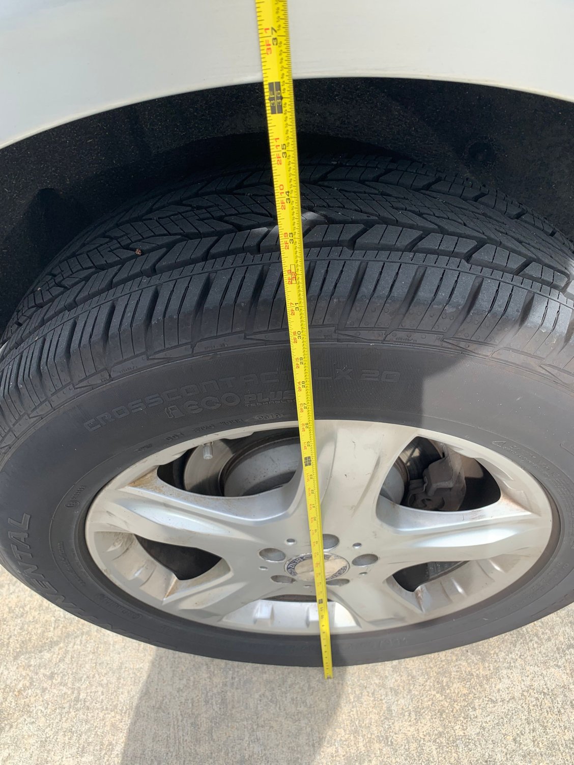

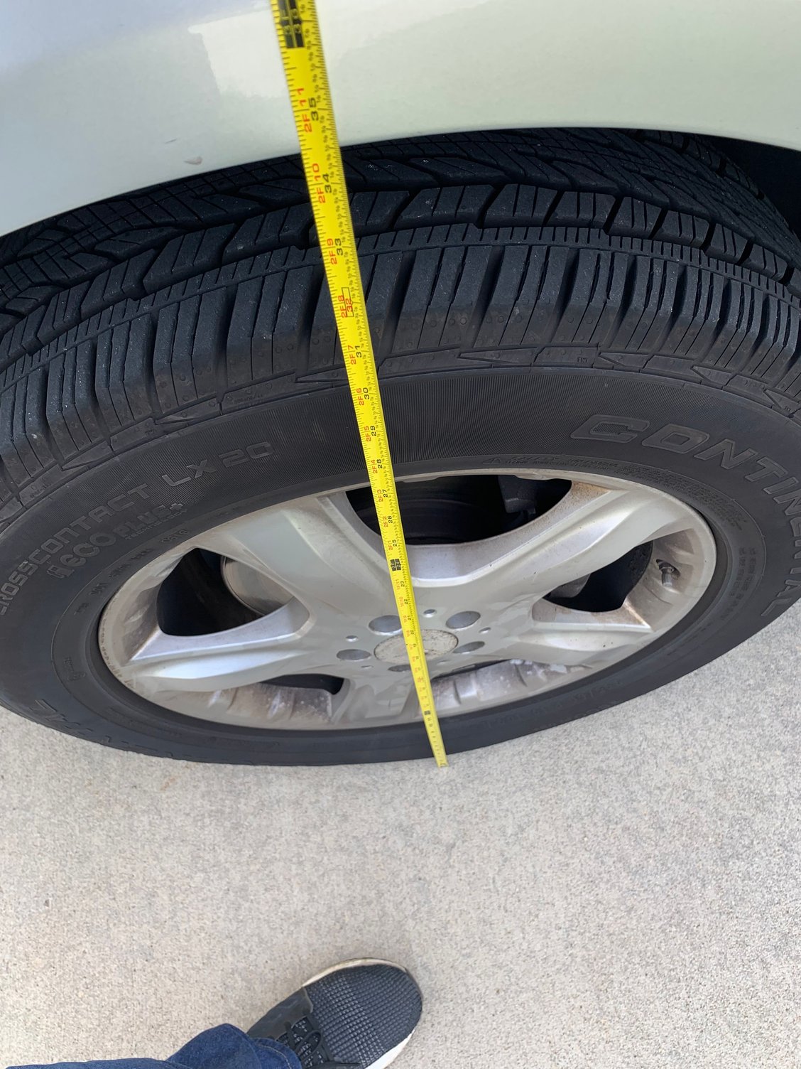

Hello everyone,
Finally the lift is installed. Its from ebay- russian company rising tuning and they were very helpful in providing pictures of spacers installed.
i had an indy shop do it while I was giving them instructions and helping on how to remove everything as I had removed the struts on the GL 3 times.
I couldnt be more happier with the results I got. Overall from stock I have gained almost 3” inches and the ML sits slightly higher than the GL on standard height.
I will post some pictures soon.
Below is the measured height after install.
https://www.ebay.com/itm/Lift-Kit-fo...oAAOSwEG5df5xT
Front:
Rear

Couple questions for you:
Can you remove non-air strut in front without removing axle?
Will the axles be ok with that steep of an angle? Pics of suspension underside and axles would be great

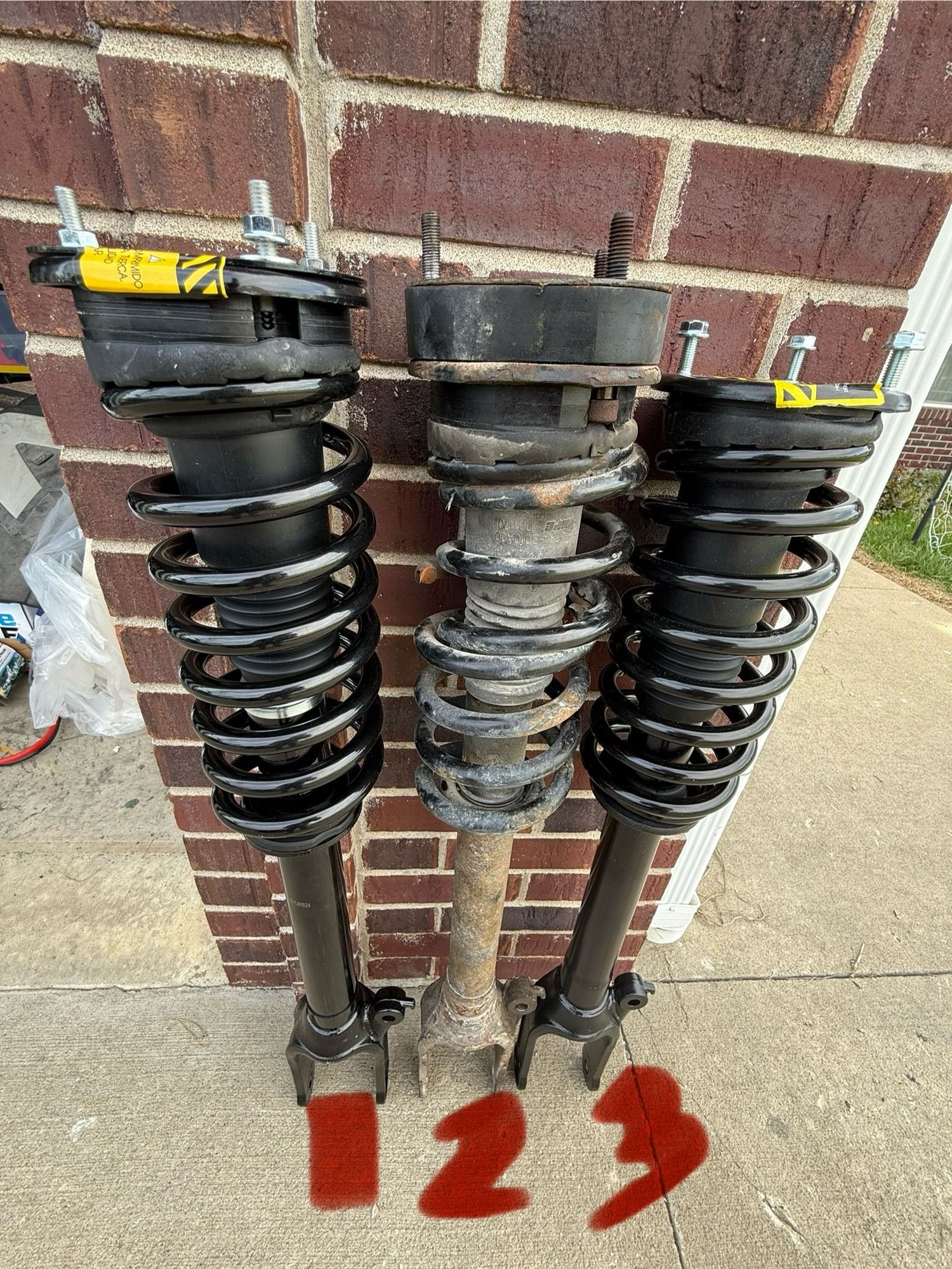

Yes you can. What you do is remove the 24 mm strut bolt. Remove the 19 or 21 upper control arm nut. Then remove the 19 mm lower link. Have a jack under the axle assembly then all you do is loosen the 36 mm axle nut. As you loosen it you will see the axle shaft pop out from the front to about an inch or so to give you clearance to lift the strut up and over the axle. Remove the top strut mount 13 mm nuts and it will come out easily towards the front of the vehicle. On air suspension the axle shaft loosening is not necessary as the blown airbag is usually deflated or aired out so its not compressed such as in the case of my GL.
The axles seem to be just fine and I have no issues whatsoever. I believe there is no difference between suspension components with air suspension and standard spring suspension, thus allowance in raising and lowering should be the same.
I have 30 mm wheel spacers coming so when I install those I will take pics of the procedure.

How do i remove the rear spring do i need to use a spring compressor? im trying to install the rear spacer i got from the same company but i dont have the instructions for the rear, i purchased from someone who removed it so any help apreciated. thank you
Old Aug 30, 2022 | 03:53 PM
Dinismb's Avatar
Joined: Oct 2016
Posts: 198
Likes: 25
2005 Mercedes C230 Kompressor, 2008 GL 320 CDI, 2008 ML320 CDI, 2016 GLE 300d AMG Night Package
You need to remove the spring control arm. To get the spring out. I dont recall exactly, but I think we tried to compress the spring so we dont habe to remove the arm, but we didnt have enough clearance. So we lowered the control arm and then mounted the spacer.
