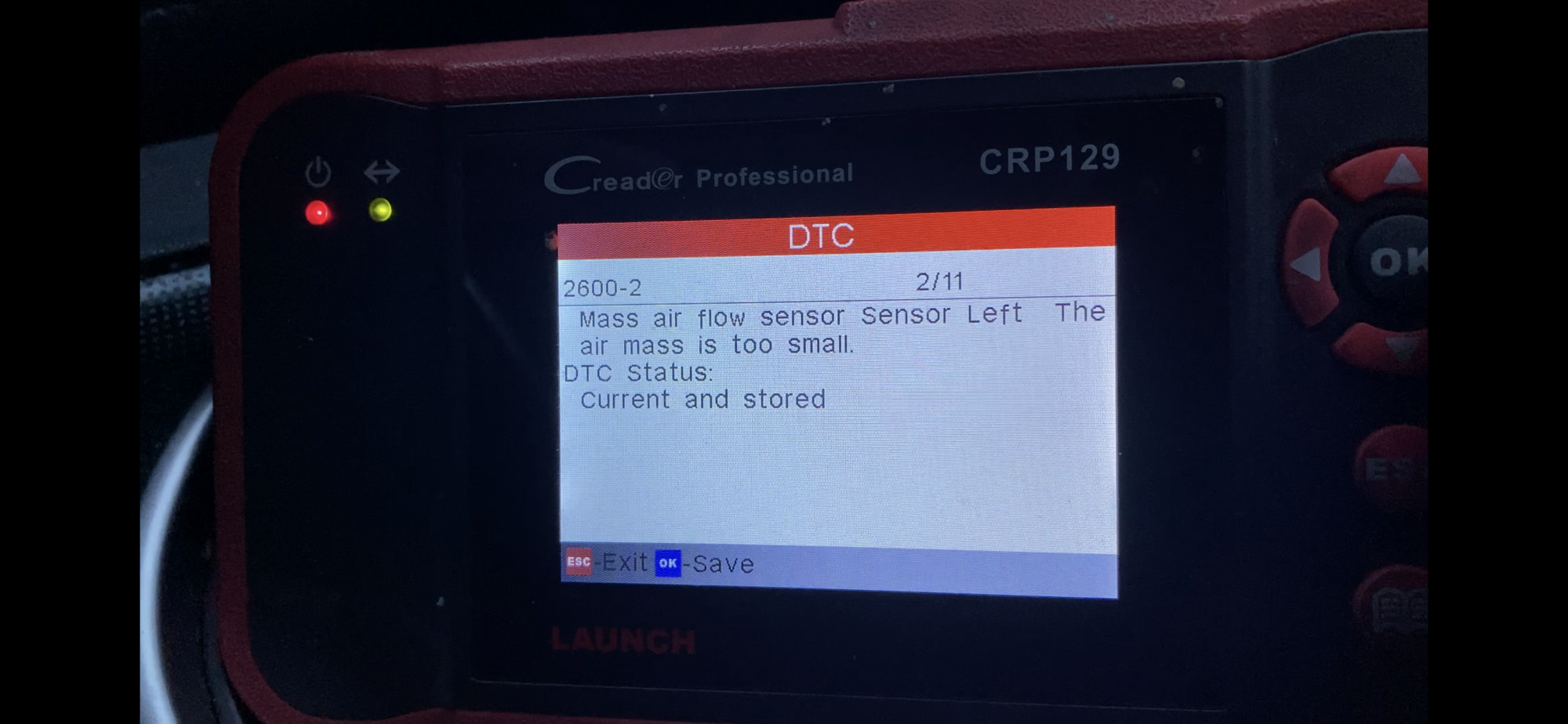

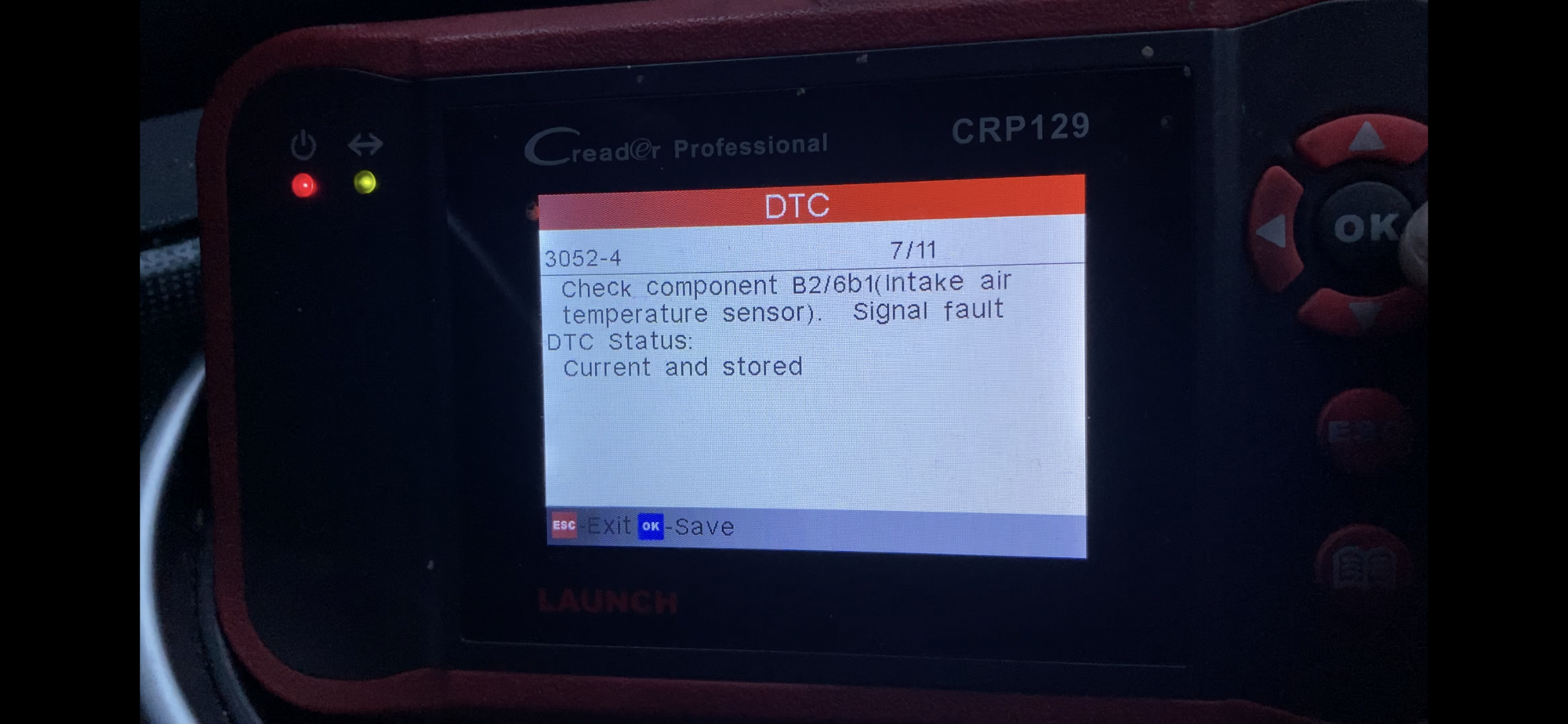

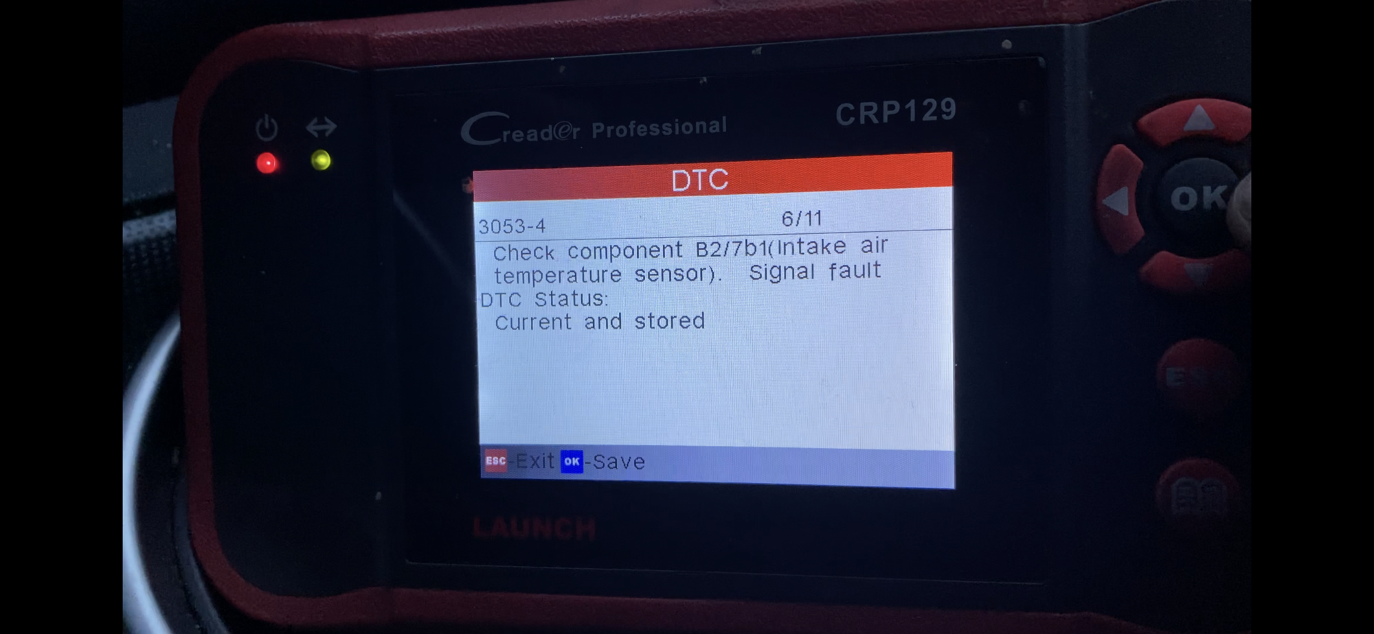

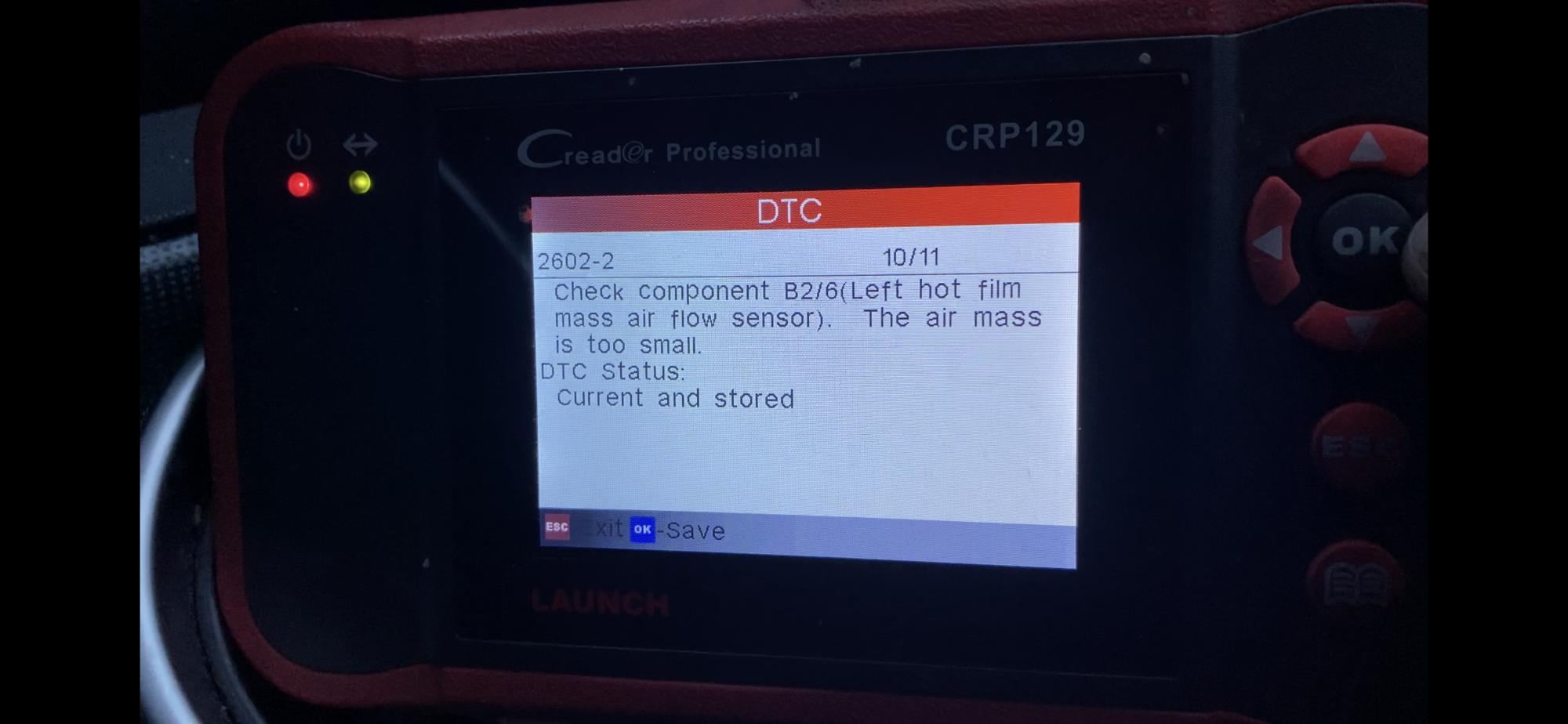

Hi there, I’m just wondering if anyone has come across this, I’ve put the code reader on the car and it’s coming up with 11 faults. Not sure if they’re all connected or wether it’s a wiring fault

it had a new turbo 6 months ago, update now is I found fuse 104 blown. Replaced fuse and now just 1 fault showing up and the mil light has gone off. It’s now showing vent line heater element short to earth
