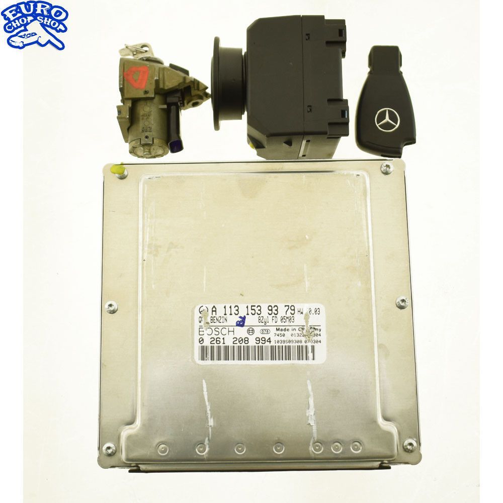

Got a matching set eco,eis,and eco as well as the door lock for $200 deal! please see attached pics​​​​​​​

As far as I know you cannot reprogram an ECM.

This place is a joke.
Great, now you'll just need the matching transmission control unit (inside the transmission) and ISM (shifter) and maybe you'll have a chance it will start and drive. Oh, and the matching radio if you want music. Yep, it's all VIN coded. Did I mention the trans ecu has to be the right part # to match your valve body? If not, you may have shifting issues. Now you'll understand why this ML was such a "good deal" and determined a total loss by the insurance co.

Originally Posted by ljm1715@me.com
if I buy everything from a salvage ml500 same year eis,key,ecu will that allow the truck to run?
No.
