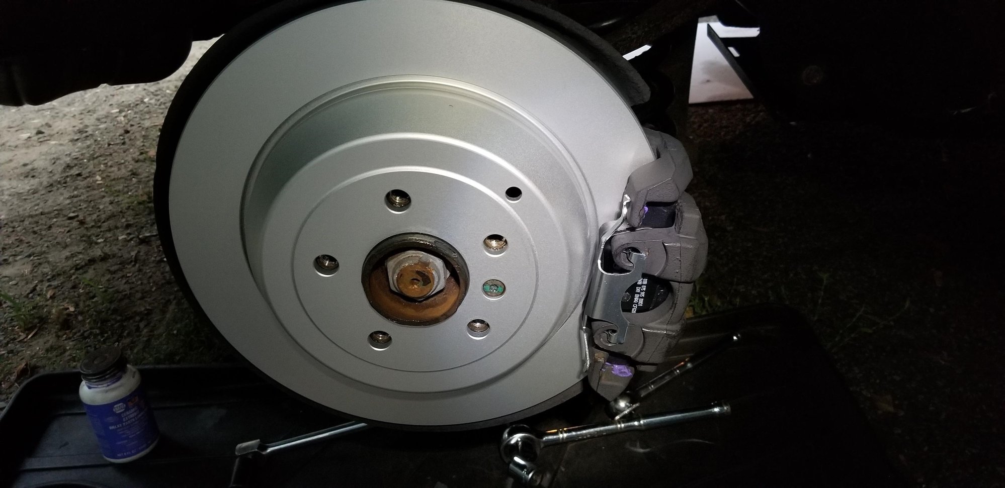

Today did passenger rear, went like clockwork as I knew the mine fields:
  1. As all videos state, remove caliper.
  2. Remove carrier; I required a 6-point impact socket, short on lower bolt, long on upper bolt with a 3/8" ratchet and a 24" pipe over the handle. The last mechanic put my bolts on way tight, 59lp is the spec and these were on TIGHT! Got them off just the same but so tight, my 12-point 18mm socket could not handle the torque.
  3. Suspend caliper with a bungee around the spring, etc to keep from hanging on hydraulic hose and up and out of the way of top carrier 18mm bolt.
  4. DO NOT try to pry off rotor, loosen star bit rotor mount bolt a few turns; hit bearing / rotor interface with liquid wrench (wait).
  5. Hit rotor you are about to replace hard with hammer on outer edge all the way around; harder if really rusted like mine; HARDER still if still in place.
  6. If you are in P, the driver side will be locked up solid; the passenger will be free-wheeling (2-wheel gogo). This is good, you have the option to align the small rubber plugged hole with the parking brake shoe adjuster; German engineering at its finest, barely can see in the hold to align the adjuster wheel and then blindly rotate with a flat head screwdriver and mild tap with a hammer; on the drivers side you are moving star adjuster down to pull parking brake shoes into a smaller circle for more clearance to remove rotor; on passenger side you are pushing adjuster stars up to do the same "tighten" of the adjuster and reduce the show circle size. This gives you enough room so you can whack the rotor and loosen it from the rusted hub interface and then still pull the rotor off without catching on the shoes. On the drivers side, I was not able to rotate the old rotor by hand to align with the adjuster and the rotor caught on the shoes and pull the show retaining pins/springs out of the disk shield holes (was ugly, I had to gently push the torn metal about the pin holes back in place and insert the pins gently so they would go back together. On the passenger side, being able to free-wheel the adjuster hole with the adjuster, once I figured out move the adjuster up (vs. down) to ease the space between show and rotor, no problem. Rotor came off without catching shoes.
  7. In my pics, you will see I wire brushed and used brake cleaner on the carrier and the visible part of the caliper back to the wear sensor and hit them both with Rustoleum 2000 F high temp flat black stove pipe paint. I was always impressed that the mechanic that did the brakes on my first car, a 1976 Olds Omega with the smallest V8 ever built (yup, that was a thing, but so smooth and cool sound); he did my brakes and painted the calipers and carriers flat black. When I asked him why, he said, most people dont, but when I see the finished product through the rim, the satisfaction outweighs the 10 min to hit them with paint; hence I have done the same ever since on every car I have owned.

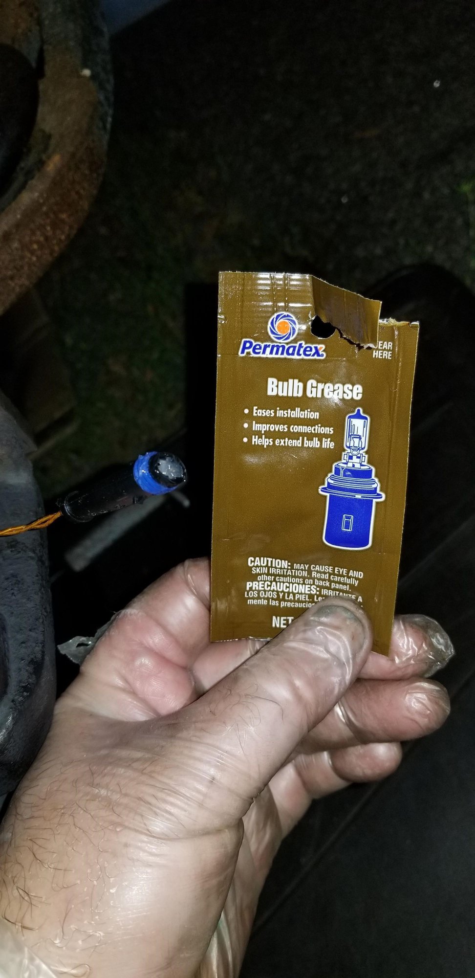

  8. On way back on, no issues, I used purple ceramic high heat brake lube sparingly; you have to install a new wear indicator on the inner passenger side pad, no issues, I hit it with bulb silicon grease used on my Yamaha Nytro sled; I could not fit my torque wrench in the opening (maybe you can from the bottom on a MB lift) so I put on my 18" breaker bar and went heavy, not coming off! I put anti-seeze on the inside rim of the bolt head and blue lock tite on the threads, not coming off I am sure and I can release it with an 18" breaker bar vs. my modified 32" nutty torque wrench / pipe removal "tool".
