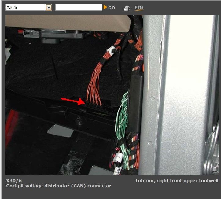

Both of my headlights are acting all wonky. Passenger side works, driver doesn't both low and high beams. Fog lights and turn signals all messed up too. Swapped the headlights, still the same issue. Female connectors at driver headlight aren't receiving any 12v. BRN ground tests good continuity.
Hooked up Xentry. Fault code for front SAM. Most likely cause:
"Cable from component X30/7 connector 1, pin 2 - to component X30/6 connector 1, pin 2"
OR
"Cable from component X30/6 connector 7, pin 2 - to N10 f30 pin 35"
Any advice where I should go with solving this problem? Color pictures help. There are connectors everywhere in the passenger footwell, and knowing exactly which one is X30/6 would really help.

Well you have to look in two different locations.
