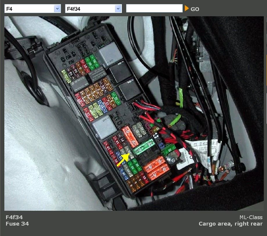

Hi, Powered down the FD window and will not power up. No motion or noises at all when switching. FD Window Switch is a little loose/funky since I got it but it worked, all other switches on the driver master control are still working. Anyone know where the fuse(s) are for the drivers power window? I have looked at lists of fuses and didn't see it listed, must be me. Thanks for reading. W164 2008 ML320

Here is the fuse location.
