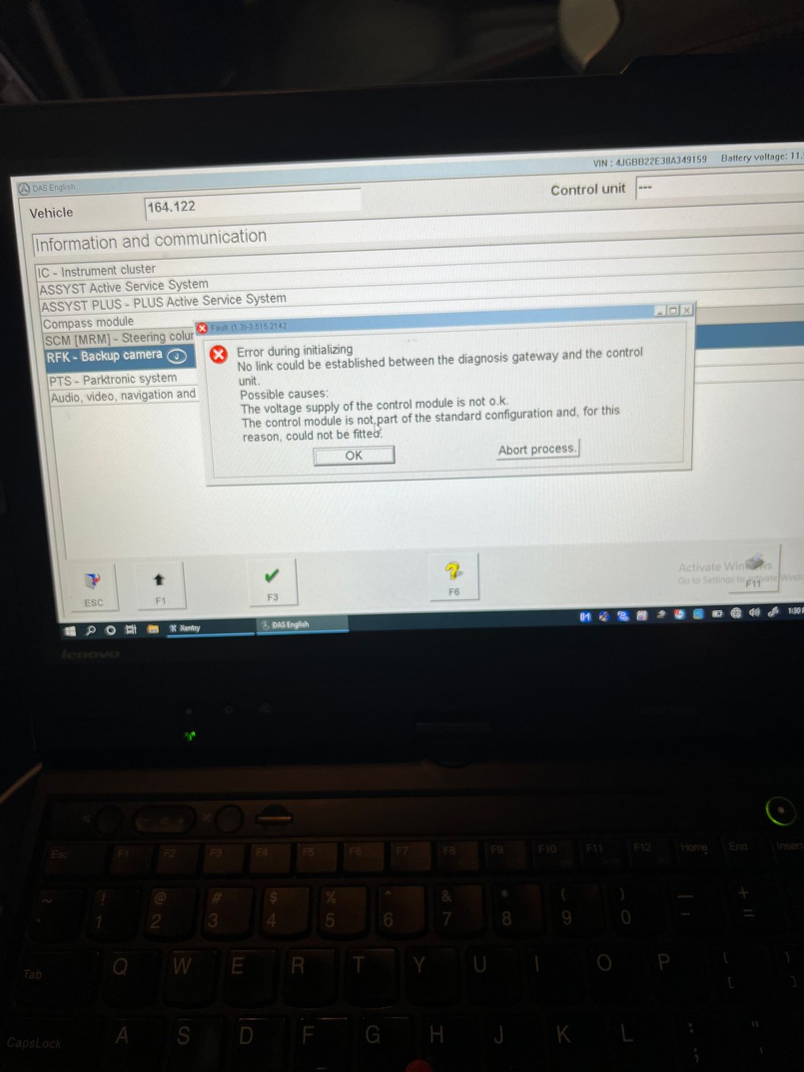

The command wont turn on or off with key on my 08 ML320. It will turn on manually and everything is working except the back up camera. The backup camera wont even activate when put in reverse. Also, command will work only for exactly 30 minutes and then it shuts off. I have to power it back up manually. However, radio, cd, cd changer, nav all work normal.
I have checked all fuses and they are fine. I ran xentry and it shows no fault codes.
One thing though I can not find the back up camera info in xentry. I looked under rear sam, front sam and IC. In fact I looked at all modules and cant find it anywhere.
Thanks in advance for your help.

On xentry, click on Info & Communication, then click on RFK Back Camera to find the codes.

Maj Dundee,
On Info & Communication I get an error message saying it can not find back up camera and command.
Its odd that commands powers up manually and everything works but the backup camera.
In the rear sam, would you be able to show me where it connect if there is a connection at all?
And as always thank you for your help

Maj Dundee,
I did a Restart of optical ring and command and backup camera are working again. Something mustve caused the MOST fiberoptic line to break the ring.
Thanks again for your help
