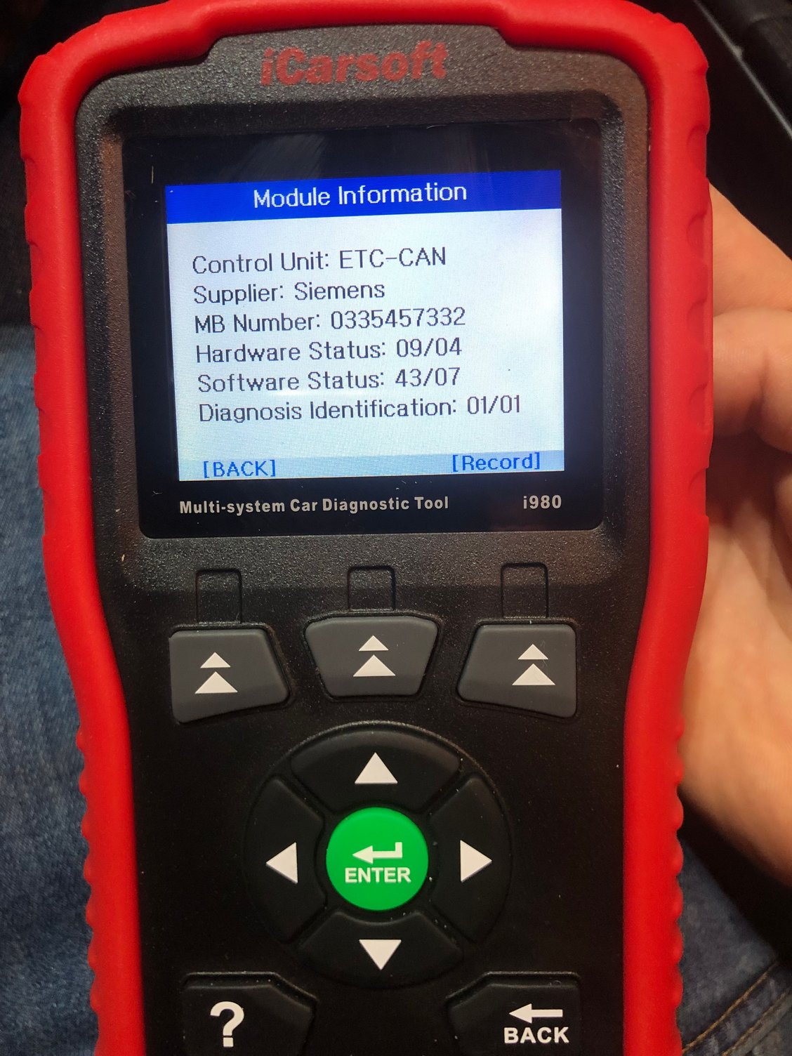

I have a 2008 Mercedes Ml320 CDI which 2 weeks ago broke down while we were driving . It still drove when it broke down so I was able to park in a safe location but after turning it off and on now it just makes spinning and grinding noises which I have demonstrated in a video in my garage.

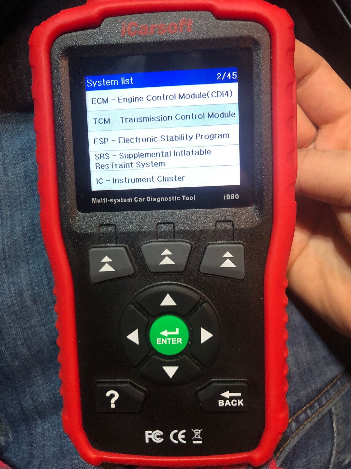

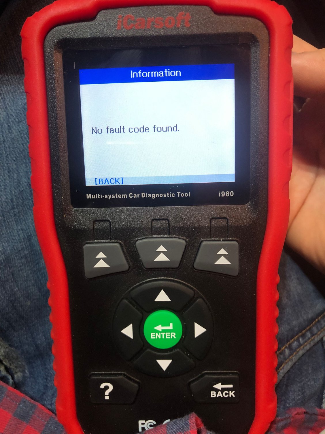

fast forward to today I have received a iCarsoft 980 scan tool which I can read codes from TCM and ISM etc. the scanner shows zero codes in the TCM and zero codes in the ISM I still cleared both just for good measure.
it does have a couple codes I was already aware about which are a MAF sensor reading slightly above normal and a steering angle sensor code causing the esp light to stay illuminated. I’ve been driving with both codes without any issues at all.
After clearing all codes the problems persist and it sounds like it’s making spinning noise in neutral gear and louder spinning/grinding noises in park so I shut the car off quickly to prevent further damage.

My guess, based on limited info of course lol, is bad torque converter but interested to see what you find out. Good luck!

The first thing I would have done is to check the transmission for the transmission oil level and clogged filter. I would in any case replace the transmission oil and the transmission oil filter. There is no dipstick on the transmission and to change the transmission fluid is a bit of a process, The process is described elsewhere in these forums. To check the oil level is a little involved. Note that this transmission takes a very specific transmission oil you can get from the MB dealership or you can order it from a place like Pelican Parts. Do NOT use regular ATF (red automatic transmission fluid).
It's worth giving the transmission a full oil and oil filter change to see if that fixes the problem before simply selling the vehicle. I have the exact same vehicle - it's 15 years old now, I've had it for the last 10 years. It still looks fantastic and I still love it!
