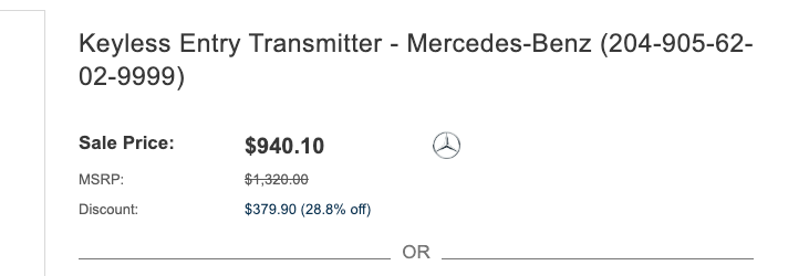

Ok, so I have an update on the key situation. The key they ordered for me (pictured above) turned out to be the WRONG key for Keyless Go, it was part 230-905-07-39-9999 (BTW, I could not see this number anywhere on the key above but it was on the invoice). This was confirmed when I brought the car in so the techs could check the programming.
They then told me that I had to buy a new key, the correct one, part 204-905-62-02-9999, and just as JettaRed suggested they might, they gave the first one to me for free (although, props to the dealer, they offered this right away). However, a week later, I got a call from the parts department - and they told me that the part is no longer available from Mercedes Parts - they are all sold out and not making any more! This seems really surprising. Sure, my car is a 2011, but this seems a little surprising!
When I asked them, they said that for the Keyless-Go keys, they said it was not possible to program an "old" Keyless Go key to my car - they had to come from Mercedes. This kind of choked me, as I do not currently have a working Keyless-Go key for the car.
Is this all true?

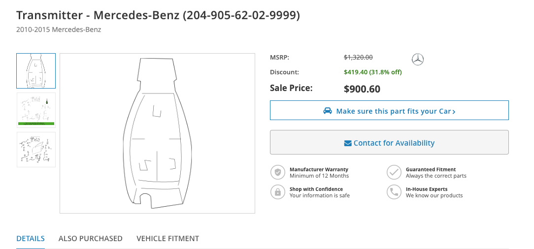

This site says they have them (other sites will say "no longer available"). BUT, $900!!!
https://www.mercedesbenz.parts/oem-p...20490562029999
Google
204-905-62-02-9999

Thanks - but it does show up as a discontinued product for me at that link.
I'm a little surprised that MB would discontinue such a "key" part for a car as this - but I guess it is basically a car that hasn't been made for almost 15 years... (W164)

https://www.autonationparts.com/oem-...20490562029999
Old Feb 6, 2024 | 03:07 AM
JettaRed's Avatar
Veteran: Army
iTrader: (1)
Joined: Nov 2016
Posts: 7,847
Likes: 3,499
From: Maryland
https://www.shopmbparts.com/oem-part...20490562029999

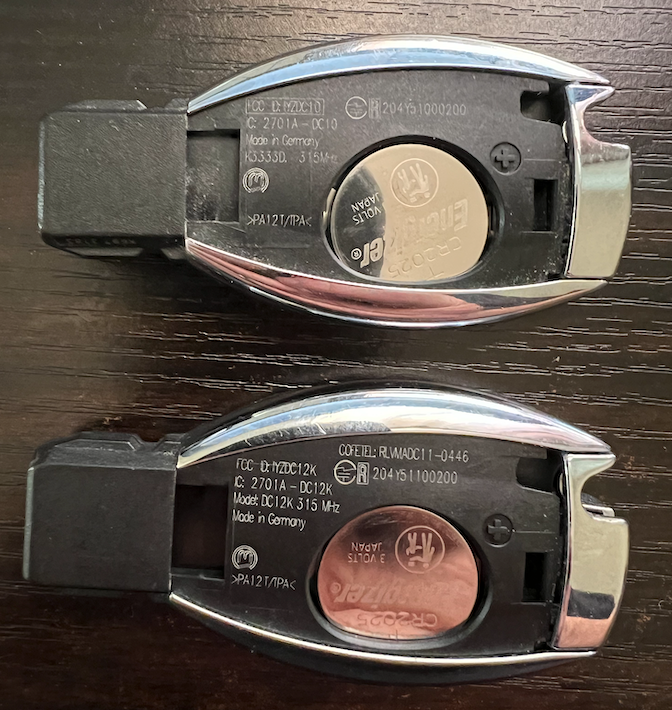

Not sure if this will help or not. I checked the numbers under the battery cover for both my 2014 C350 (top) and my 2015 SL400 (bottom), both with Keyless Go. Not sure if the 204Y51000200 and 204Y51100200 are part numbers. The model numbers for the fobs are as follows:
2014: DC10
2015: DC12K
Old Feb 6, 2024 | 06:10 PM

Thank you! This is helpful.
