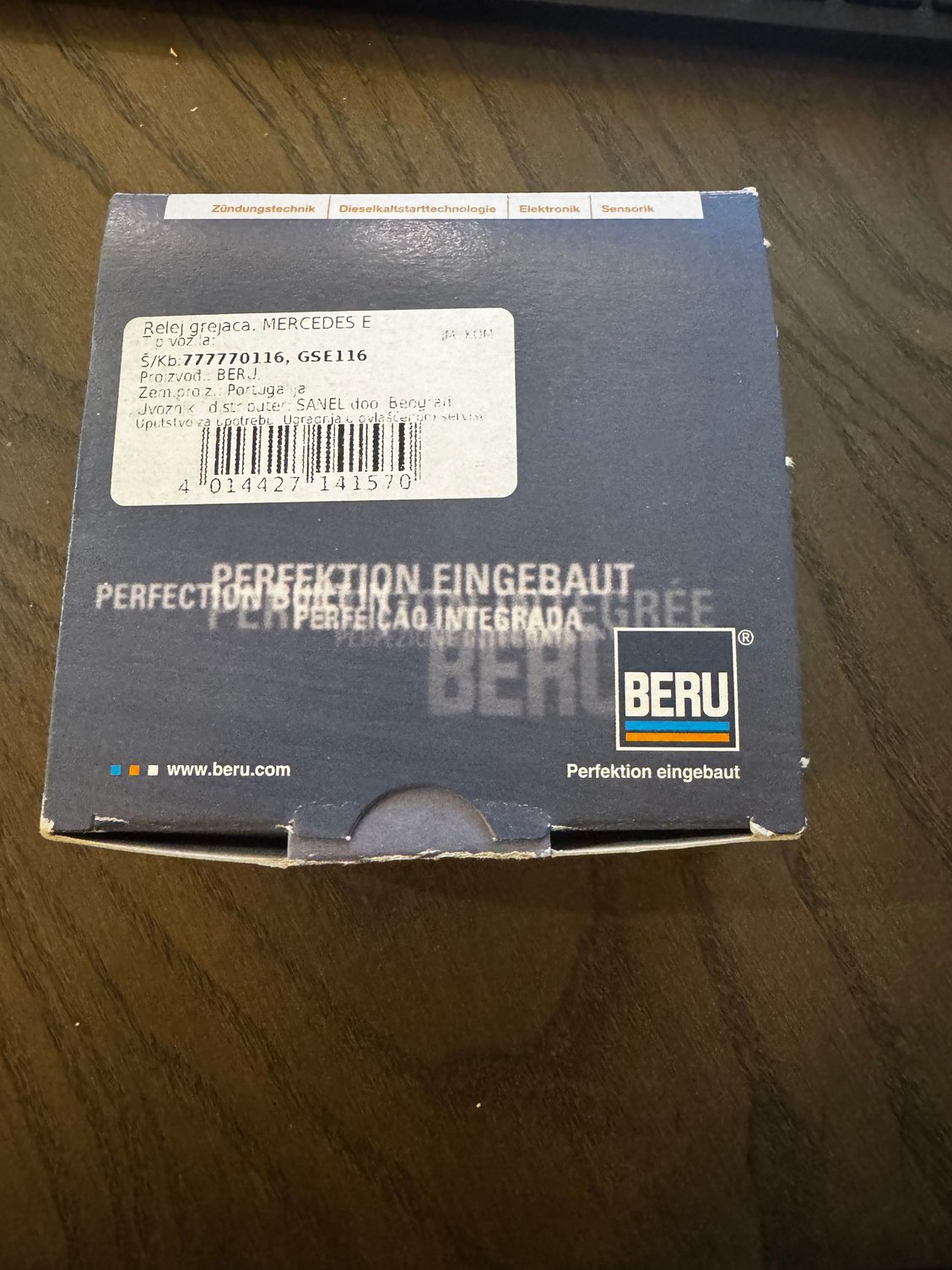

it looks like this might solve my long crank no start problem,gse 114 and 116 are different so dont mix them up,

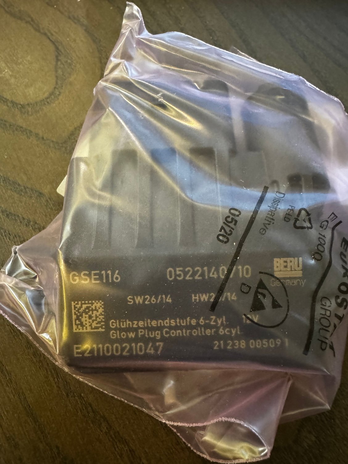

Its here,120euros,should be easy,only 3 e10 bolts

easy job,get a curve extension but be VERY careful with connectors,if you car is older they might be brittle,engine starts about a half second quicker id say

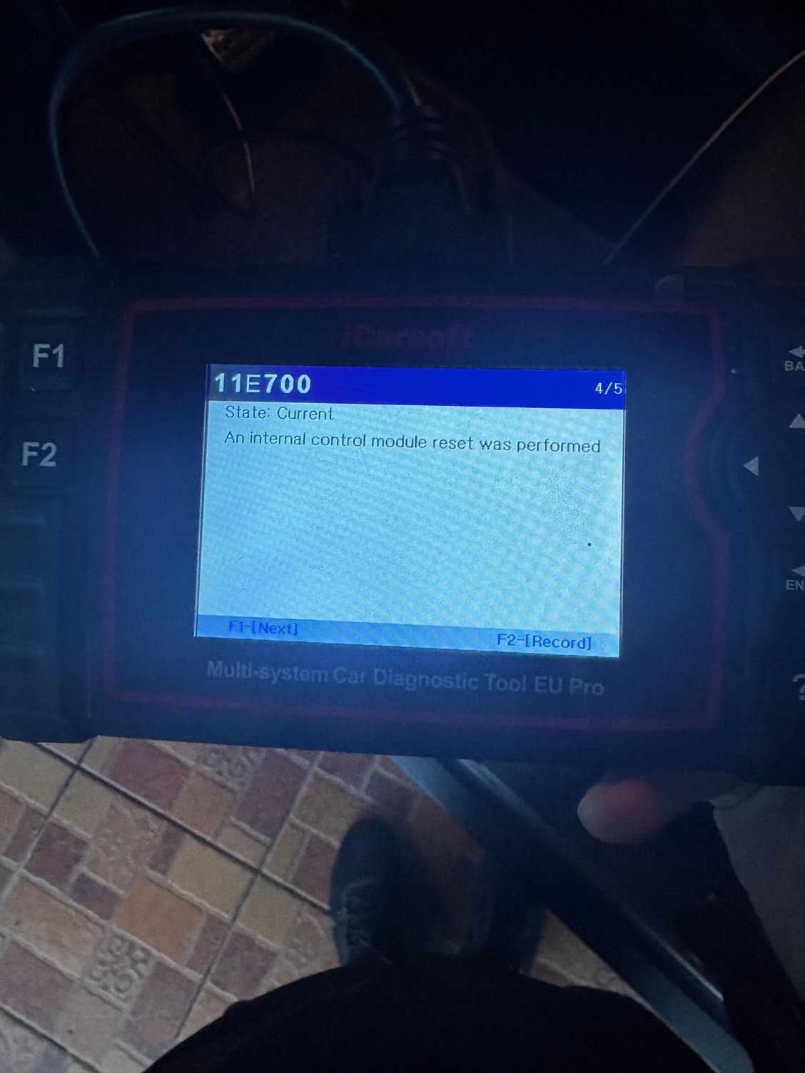

ok battery is fully charged and still only cranks i was able to pull these codes
