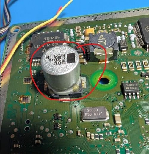

Old Jul 11, 2025 | 03:56 PM
  #73
TammyCutzer's Avatar
Joined: Aug 2021
Posts: 23
From: Houston
Ml550 2009
I had a very similar problem, and it was the ECU at the end.
Capacitor leaked on the PCB, electrolyte destroyed the PCB, caused arcing and burnt traces.
I got a used ECU and cloned the data from the old to the new. Car is running fine now.
What process did you take to clone the ECU, Did you do it yourself?
Old Aug 25, 2025 | 08:51 PM
  #75
Joined: Aug 2021
Posts: 23
From: Houston
Ml550 2009
Yes, I did this myself using ktag
