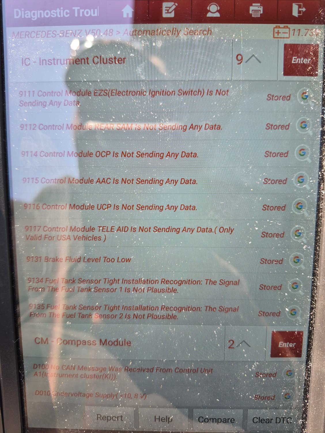

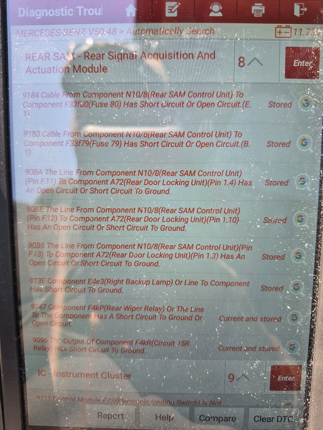

Hi all. i am new here, i have 07 ml500 thats goes into drive but wont shift out of 1st. was getting battery under voltage codes, but in have a basic scanner, replaced the both both batteries. dropped the valve body, cleaned conductor plate and changed fluid and filter. the car does not jerk going into drive or park no more. but still wont shift out of 1st gear, and manual shift is not working either. i think its the valve body and conductor plate. Please help if you have experience with this. if you have a valve body and not too far, will buy. also looking for someone who can program
[img alt="Havving voltage problems
"]https://cimg1.ibsrv.net/gimg/www.mbworld.org-vbulletin/2000x1504/20260505_110358_dfc0ad5f0d245d15364734c85b5b0e9589 40d2c8.jpg[/img]

Have you cleared all the codes?

2010 ML550 VIN WDC1641722A564750, 2010 B180
Yes. Mine was the ABS Speed sensor. Locked up the trans and gave an almighty thump when engaging. Cleared codes and away it went. But you MUST havr a solid battery and alternator. At least 13.6v engine on and 12.6v engine off or the modules which hate even a small drop in voltage send all sorts of codes which quickly spread as per my example. Without stable power, its like trying to check your oil when youre on a 45 degree slope.
