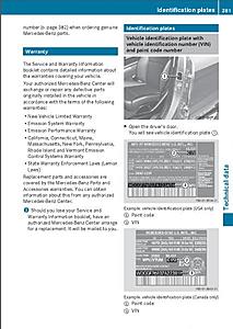

I have a 2012 ML350 in Diamond White. I want to determine if it is a ceramaclear paint, which if it is should be shown in the paint code starting with a "C". Where can I find this paint code on the vehicle?

On the Identification Plate inside the Drivers Side Door. See page 381 of the Owner Manual.
Attached Thumbnails Where is paint code location?-ml-paint-code-location.jpg

Thanks! You are correct and I found it. It is 799 which is the code for diamond white. There is no "C" in front of that number so I think it must be the regular clear coat and not ceramiclear. When in doubt, check the manual - thanks again.
