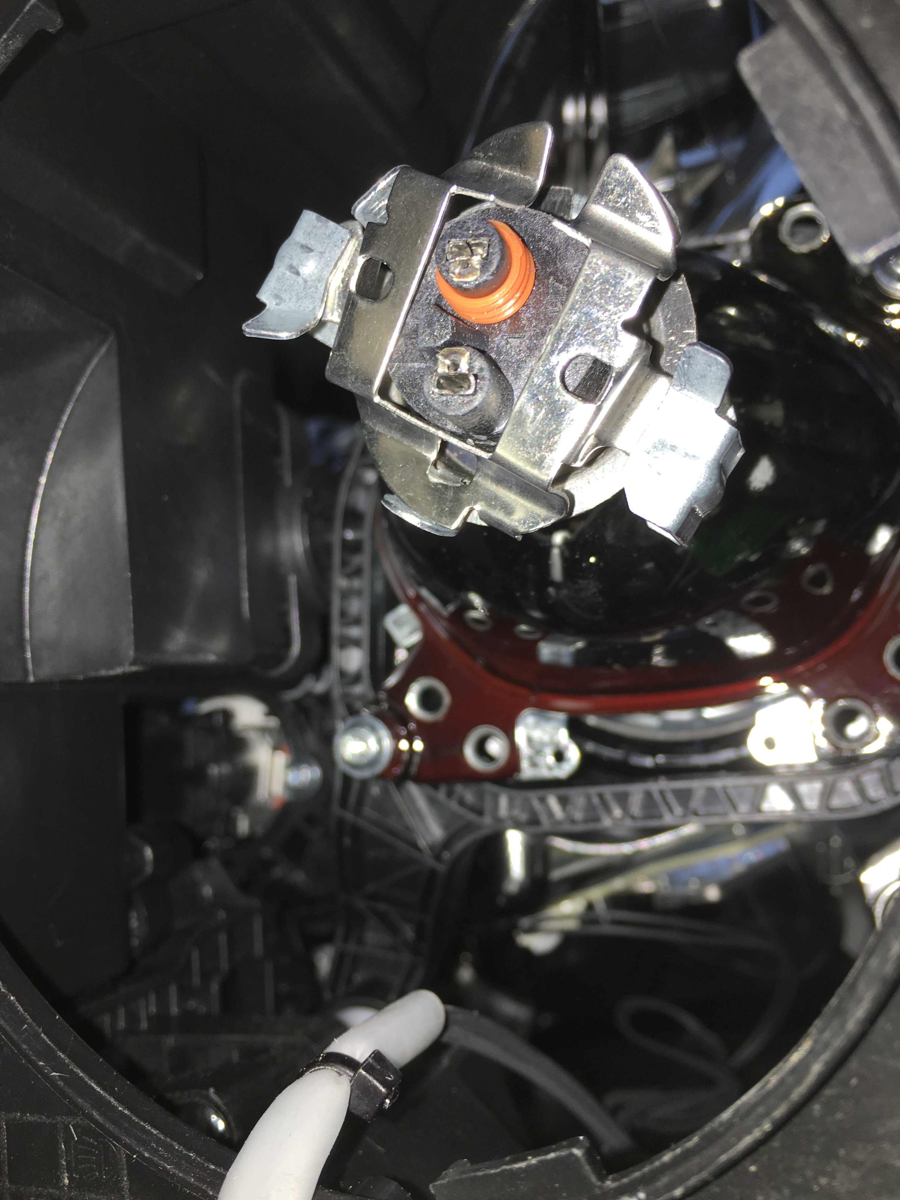

This is how I installed the bulbs with the aftermarket retainer clips. I didn't have to bend or modify anything.

Two things: I have the same clips and bulb base however my clip does not sit flush in any way with the base of the bulb. It seems like with the clips, they are rounded in so it will not go over. This is what I end up with when I try to do what you did.
http://imgur.com/a/ynuQK
second thing: do you prevent the shadow from the wire? Does the wire orientation matter?

Wire orientation does matter, you want to try and keep the return wire of the HID bulb on the bottom when locked into place.
Watch this video and you'll understand what I'm talking about:
The way I installed it was by inserting the bulb into the socket without the clips. Then position the clips over the bulb and rotating the clips to lock in place. Since one end of the clip has an opening, it makes it easier to bend. With that said, use a little elbow grease and I'm sure you will get it to lock into place.
