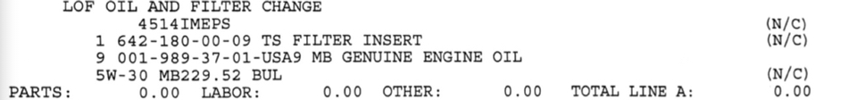

2018 GLC 4MATIC
Dealer used W5-30 MB229.52 oil.
Is it wrong type?

The question itself is not worded correctly. It's like asking if hay is a good food for animals. It is for horses, but not so much for dogs.
A 229.5 spec oil (like the M1 0W-40) is for gasoline engines, and the M1 0W-40 is a very decent oil.
A 229.52 spec oil - in 5W-30 viscosity - is the proper oil for a diesel Bluetec. DanD - that's exactly what you should have in your car.
