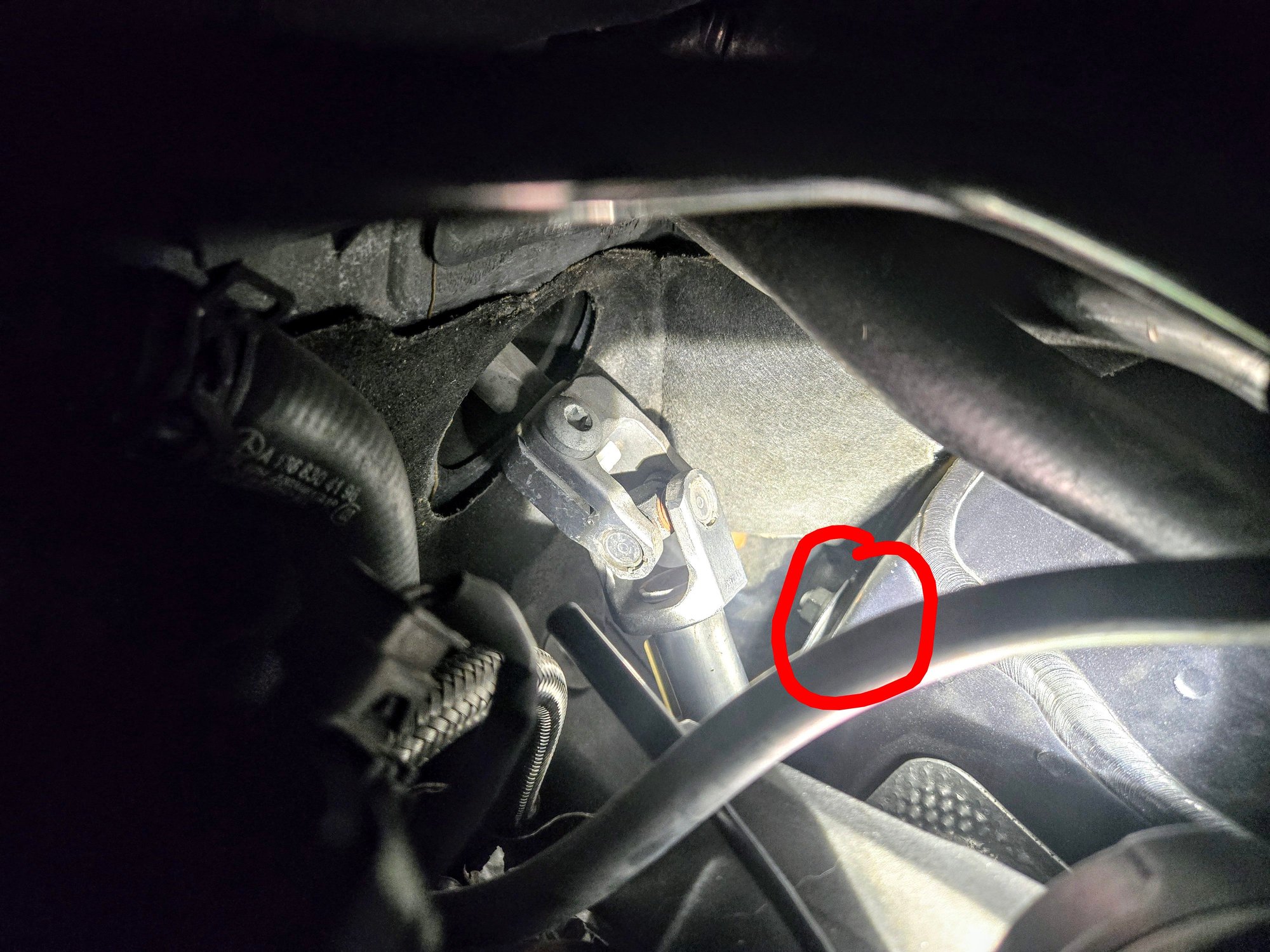

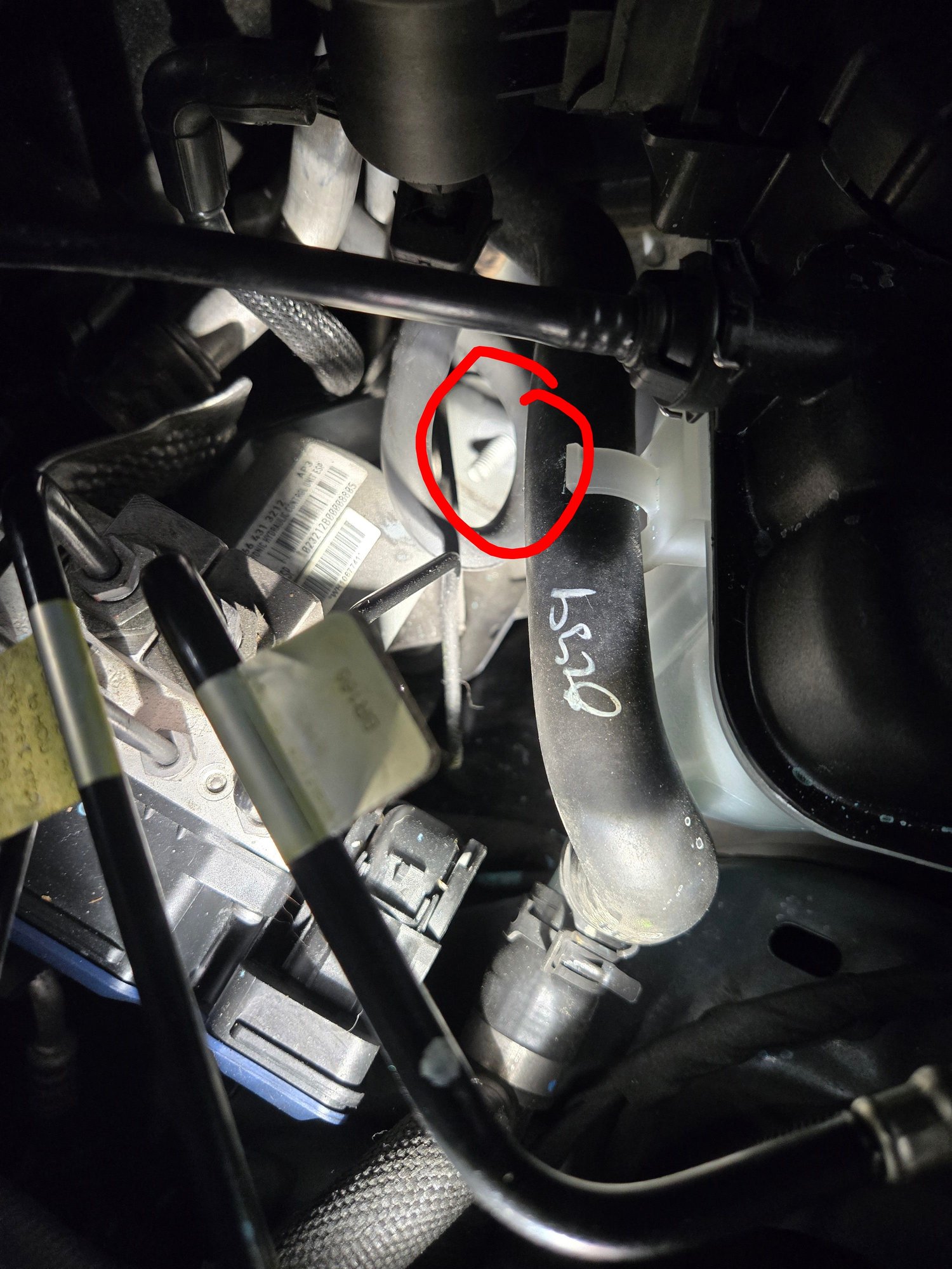

Okay, I have successfully replaced the driver side upper control arm. It is not a one-person job, unless your right arm is 5 feet long and hinged in at least four places.
This is the rear nut location for the upper control arm. I had to remove the airbox to get access. It is 16mm, and the corresponding bolt is M12 exterior torx. I had to lay on the engine to get my arm in there and had my wife tighten it from the torx bolt side.
This is where the front bolt protrudes through the inner fender well. Getting a wrench on it to remove it was doable. Getting my hand down there to get the nut onto it, notsomuch. I have one of those bendy grabber tools, and managed to get it on with that, using sheer determination and luck.
