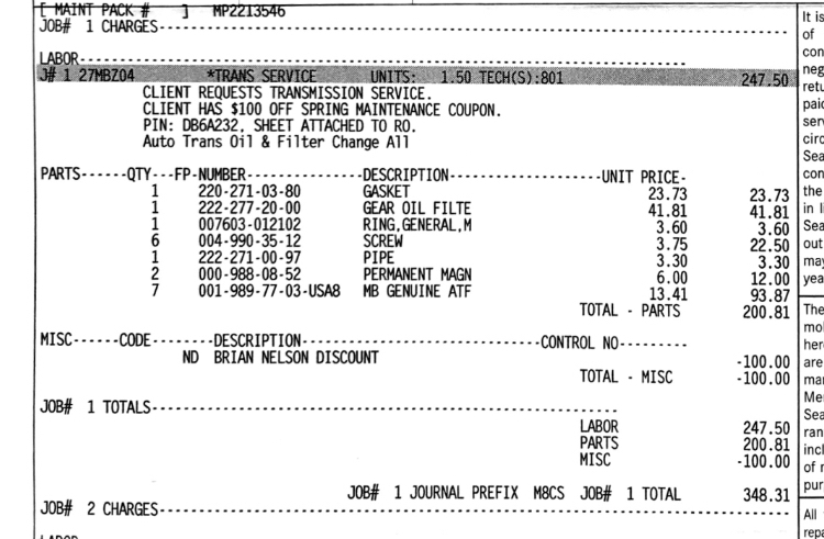

Hey everyone,
I do my own maintenance on my ML and now I`m due for a transmission service. I`m not going to do that job by myself since I don`t have the necessary tools/machines to do it. So my question is, which oil goes in there? I think my transmission is the 7G+ which uses the blue colored oil, but which MB approved rating is it? I know there are some for sale on Rockauto (see link below).
https://www.rockauto.com/en/catalog/...on+fluid,11387
I personally like to use Mobil1 for my engine oil (0W30 - 229.52 MB approved)... I wonder if they make transmission oil? Is there a chart somewhere that can show which MB approved transmission oil to use? Thanks guys.

I can only help with part number from the dealer receipt.
Attachment 417173
Thanks!
