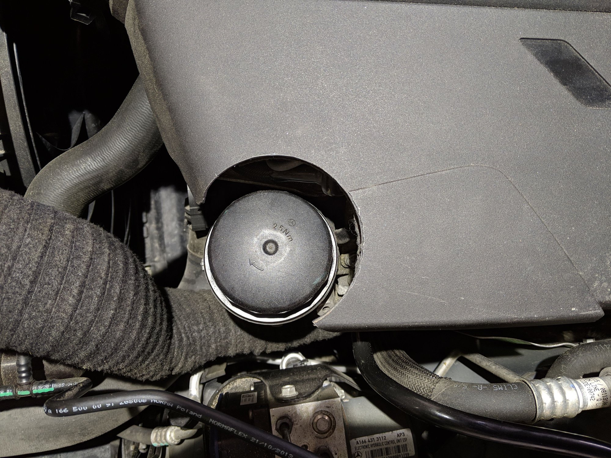

FYI the tall Cummins filter does fit, and I don't believe it is even touching the hood liner because I don't see any indents or feel any resistance when closing the hood. speaking of filters, from all the reading/research i did on Cummins forums it looks like your best options for filters are Donaldson DBL7349 or Fleetguard LF16035. The fleetguard was more money, it was looking like $30 CAD or more for me to get it, but i managed to find the Donaldson filter at a local Kenworth dealer for $12 CAD! here are some specs from the filters i found during my research.

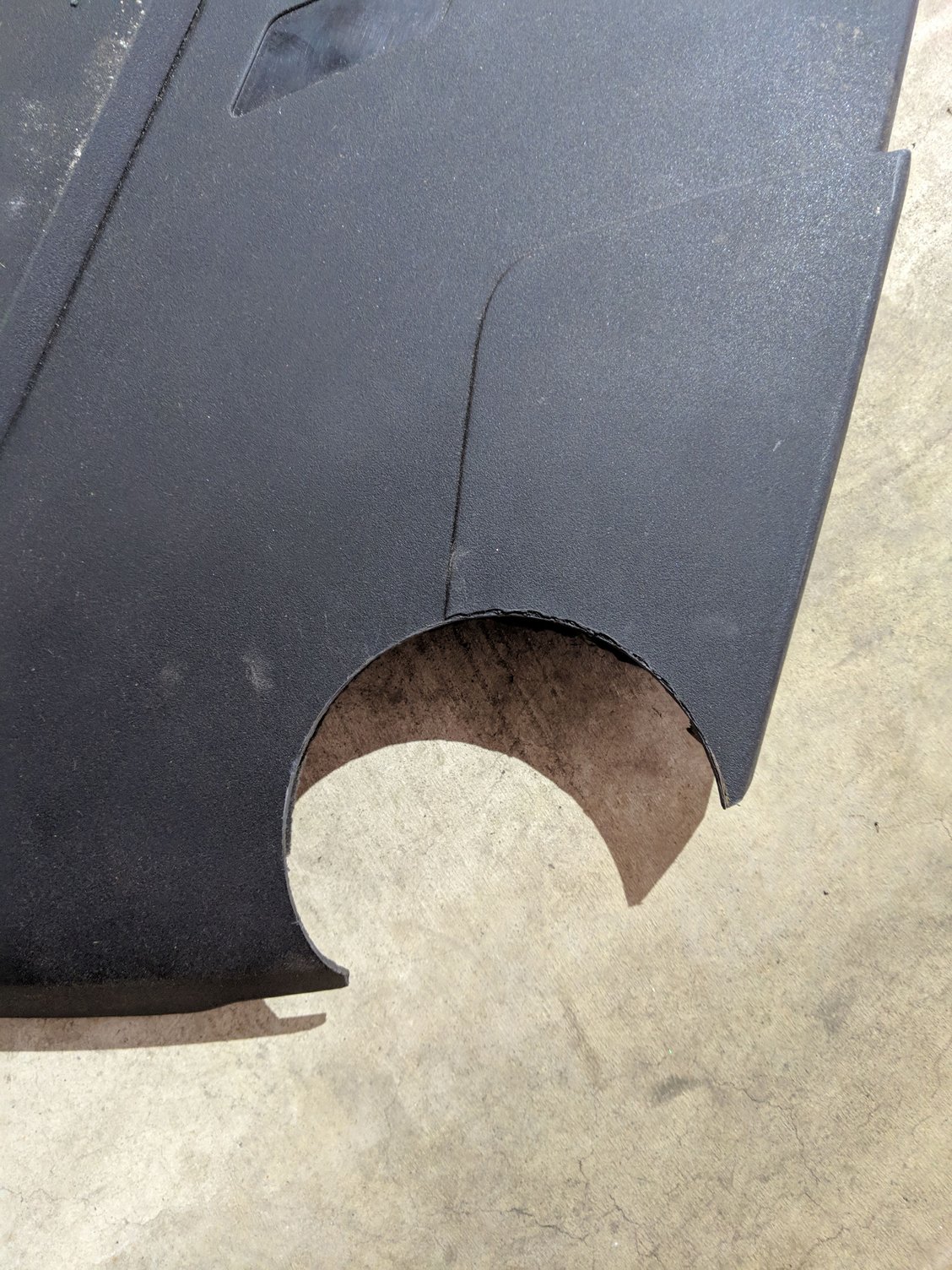

-4" or bigger hole saw to trim engine cover
-exacto knife
here is my awesome high tech work area setup. a bungee cord and a super powerful white led work light from costco
had to trim the engine cover. i used a 4" hole saw and did my best to center it around the filter, used the exacto to cut away the felt liner after i cut the hole. looking at the last pic showing the cover over the filter i felt like i did a bang up job and had some nice wiggle room around the filter (i was wrong)

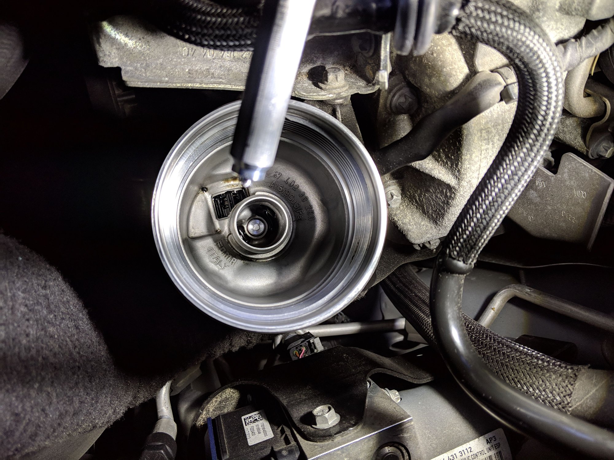

while the oil is draining i took off the stock filter, and then also used the extractor to suck the oil out of the filter housing. then i used shop towels to clean the filter housing up as much as i could. then i even used q tips to reach down to the very bottom and clean that area up of oil because there is a plug that gets installed in there. this is what it looked like after i cleaned everything up. the red circle shows a spot where a hose with a rubber grommet is held, pull it off to have more working room when installing the filter adapter.
put a drop of red thread lock on the plug. the sides of the plug definitely make contact so that is a good spot, i placed it a little near the coned part and mainly on the side
shove in the plug and gently tap it in. i was told to be careful not to hammer at it too hard and break anything, this was the toughest part for me. i wanted to make sure it was in enough, but i also didnt want to try to jam it in too much. i used a hammer and a punch and gently tapped at it until i didn't really feel it moving much more.
wiggle and break off the tube that is used to put in the plug

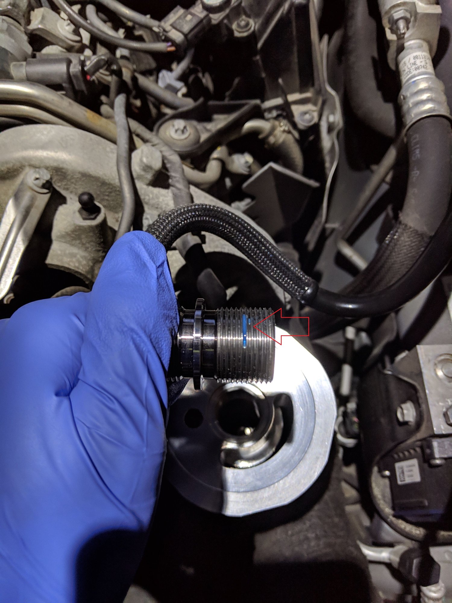

time to screw in the adapter. make sure to oil the 2 o rings (red arrows), and apply a drop of blue thread lock on the threads (blue arrow). then place it in the housing and screw it in. once you think it is screwed in as far as it will go, screw it in more. the o ring gives quite some resistance, but you will hit a point where it will no longer budge or move because it has bottomed out on the housing. it's an awkward spot and you pretty much have to do this by hand so grip strength plays a role as well, but grab it and turn it till it won't go anymore.
now get your filter adapter and also apply a drop of blue threadlock to the threads before screwing it in (red arrow). same thing with this one, it will bottom out and wont go any further once it is in as far as it will go
make sure to put back the hose with the rubber grommet if you pulled it out

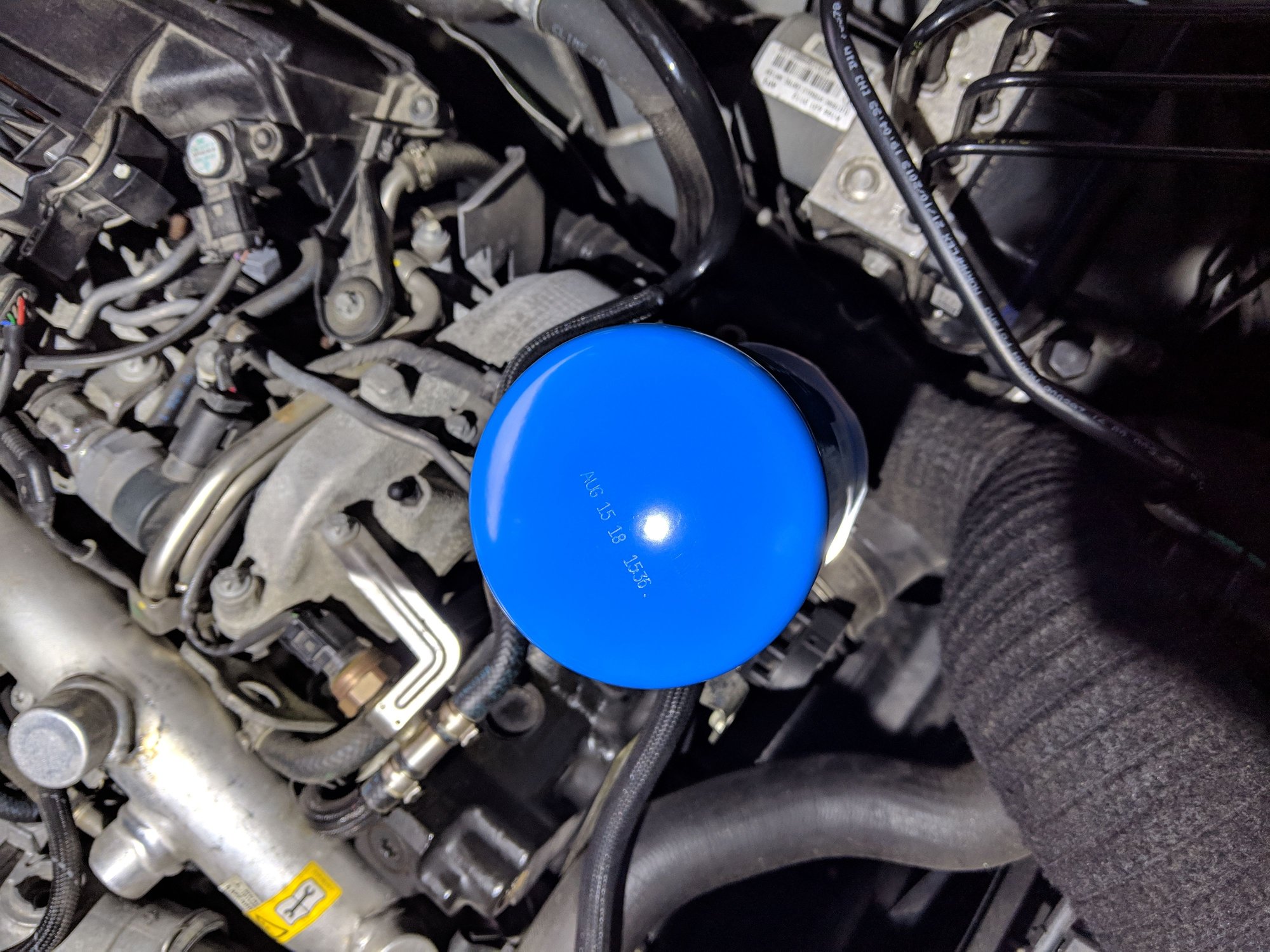

before starting all of this i took the car for a good highway drive to get the oil hot, and also extracted some oil that i sent off to blackstone for oil analysis. I'm curious what the results will be like because this is what your oil looks like if you follow the recommended 15000km/1 yr change interval. i was just under 15000 km and about 3-5 days over 1 year exactly. here is what my stock filter looked like.
i put on the new donaldson filter. the filter shows to screw it in until the gasket makes contact, then to do 1 whole turn extra. i did not use the filter wrench for this, i was just going to do it by hand, and i did not manage to get 1 full turn after the gasket made contact. i want to say i got just under 3/4 of a turn. here are 2 photos. 1st one showing position once gasket made contact, second one once i was done screwing it in and felt it had enough.

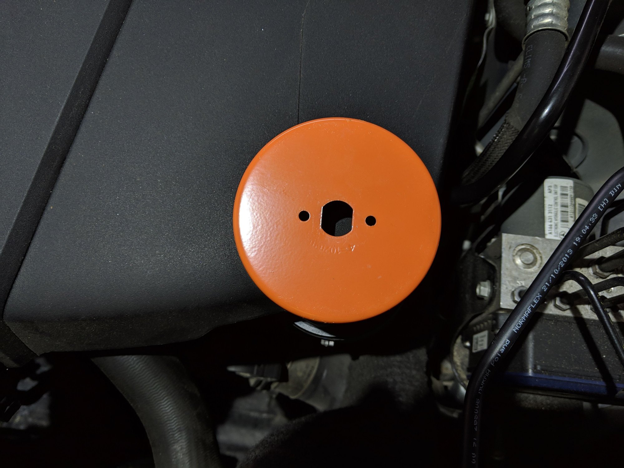

all done and what it looks like. due to the angle the filter housing is on my hole in the engine cover wasnt good enough. it fits, but it doesnt slide over/in easily because the filter sits like a leaning tower of pisa. i took the exacto at it again and shaved a bit more plastic off. it doenst look nice and pretty anymore, but maybe another weekend i will sand it down to make it look nicer.

yup no problems with clearance. i was super cautious when closing the hood the first time, and closed the hood gently by hand and tried to see if i could feel any resistance, i felt absolutely nothing in terms of resistance or pushing back when gently trying to lock it in place. worst case it may be just touching the hood liner and barely at that because i see no indents in the hood liner from anything pressing up against it.
i tried to take a photo but it's dark and even with a light if you dont get the right angle its hard to see. the below pic is with the hood latched, but me pulling up on it as much as the latch will allow and shining a light in. you can see the top of the filter, but you only see darkness above because the hood liner isnt even close enough to the filter at this point for the light to illuminate it.
