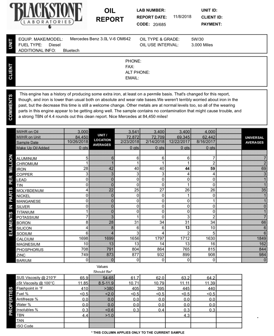

Oil Analysis 1
This is my first analysis on my recently purchased 2014 Mercedes ML350 Bluetec. A little disappointing Iron number considering the low mileage and short drain interval and 90% highway driving. Silicon is possibly a culprit as I found one of the air filter seals was torn. It has been replaced and will continue to test. Sticking to 5K change at this point. Sticking to 229.52 spec oils for now, as it is a CPO, so I am still under warranty. Would love to try the Mobil 1 X3 0W-40, but it is a little hard to find. It is the only 40W under the 229.52 approval.
Till I switched to 3-3.5K intervals iron was hight. 3K intervals brought it down, please see the lates report.
Attachment 419486

My iron was always high too (blackstone reports). I started by using Mobil1 5W-40 esp formula M, but no longer available. Now I am using Pentosyn 5W-40.
Don't know what the most recent iron levels are as I have not sent in a sample, but I am changing oil at 5000 miles.
Must be a common issue for these engines.

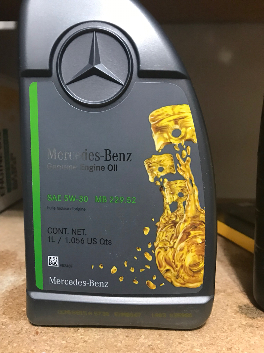

Last 12K miles Im using
