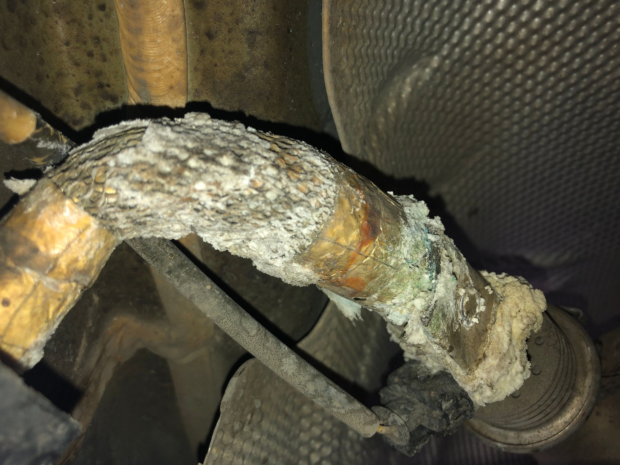

Quote: Hey everyone,
I get the P20B9 check engine light (Reductant Heater A Control Circuit/Open) but the suv seems to run fine. I initially thought the problem was the heater crapping out but I think it's a wiring issue since I don't get the X amount of starts left on my dash. Also, if the heater crapped out, the def would freeze in the -30C temperature we had here in Ontario.
Anyways, so I proceeded to drop the tank and accidentally broke the long/slim black nozzle on the def fluid pump (I was pissed). Do I need the change the entire pump now? Gluing the small piece back in doesn't seem possible. Anyone else with the P20B9 code that could help? A part of me wants to say ?&*( all of this crap and put the chip/emulator in and never touch the crappy SCR system ever again.
VIN = 4JGDA2EB4DA231578
Thank you in advance!

Quote: Correct. The CEL is gone. Regarding the inspection of the old one, I found nothing out of the ordinary. Everything seemed fine except that it was covered in road junk. I guess that salt and dirt got in the exhaust insert. Can't tell 100% for sure though.

No adaptations/coding was needed for me. I only erased the CEL and it never came back.

That's a good question! It was 5 years ago, so I unfortunately don't remember the part number. Have you tried calling your local dealership to ask them?
I'm assuming your GL350 is between 2013 and 2015-2016 (X166)? This seems to be the part you need (call your dealer to make sure!):
https://www.idparts.com/diesel-exhau...4-p-15891.html
Here's a video I found on how to do it yourself:
Parts number seems to be 1664702224.
Found one on Ebay for much cheaper!
https://www.ebay.com/p/782852963
Good luck!

It's been so long, I hardly remember. I broke the nipple because I lowered the tank too much/quickly before disconnecting it. So drop it very slowly, try to reach and disonnect the nipple. If you can't reach it, drop it again VERY SLOWLY. Go gradually.
