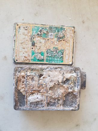

I believe you have to contact the dealer for your specific year and model since there are two different type of blind spot assist. I also think they updated the seal recently. I replaced both of my sensors on my glk and i order the parts from ebay Germany seller. Please do not get the Chinese made one. I tried, they don't work. It was a nightmare to get the money back. The German seller on ebay are selling it for $400 cad, which is like half ot the price compare to the dealer. Depends on how corroded your sensors are, you may have to replace the cable connection as well, which happened in my Glk. When you get your new sensor, I will add a layor of Silicon in the gap to prevent water penetrate the senaors again.
