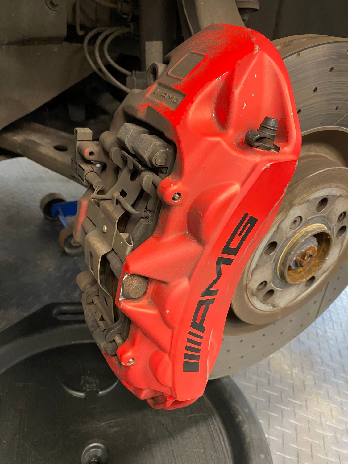

You can see the paint peeling and chips. Luckily Porsche Guards Red is a PERFECT match for the calipers. I’ll link the touch up paint below.

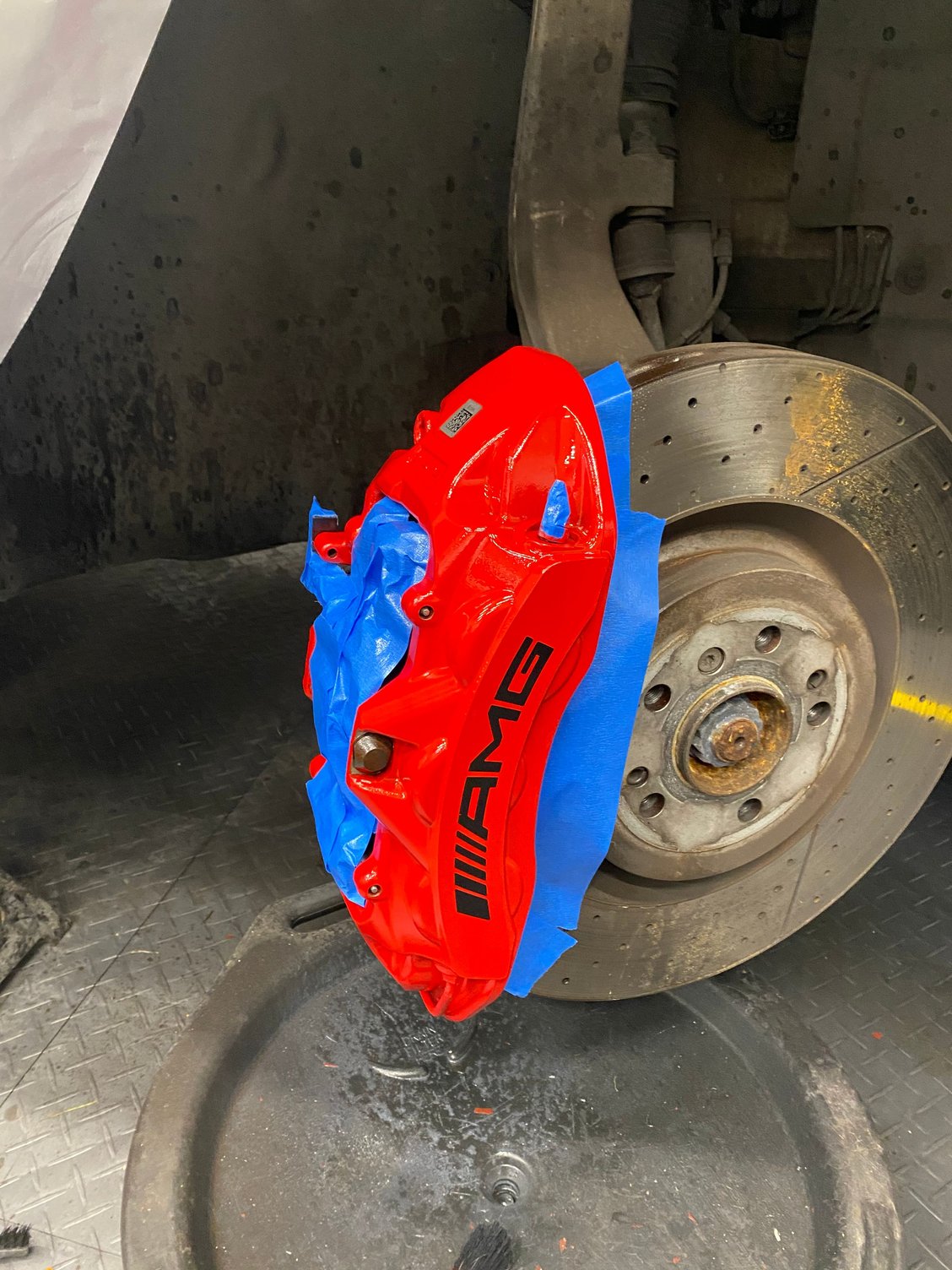

Now mask all areas to avoid overspray. Don’t forget to cover the paintwork too!

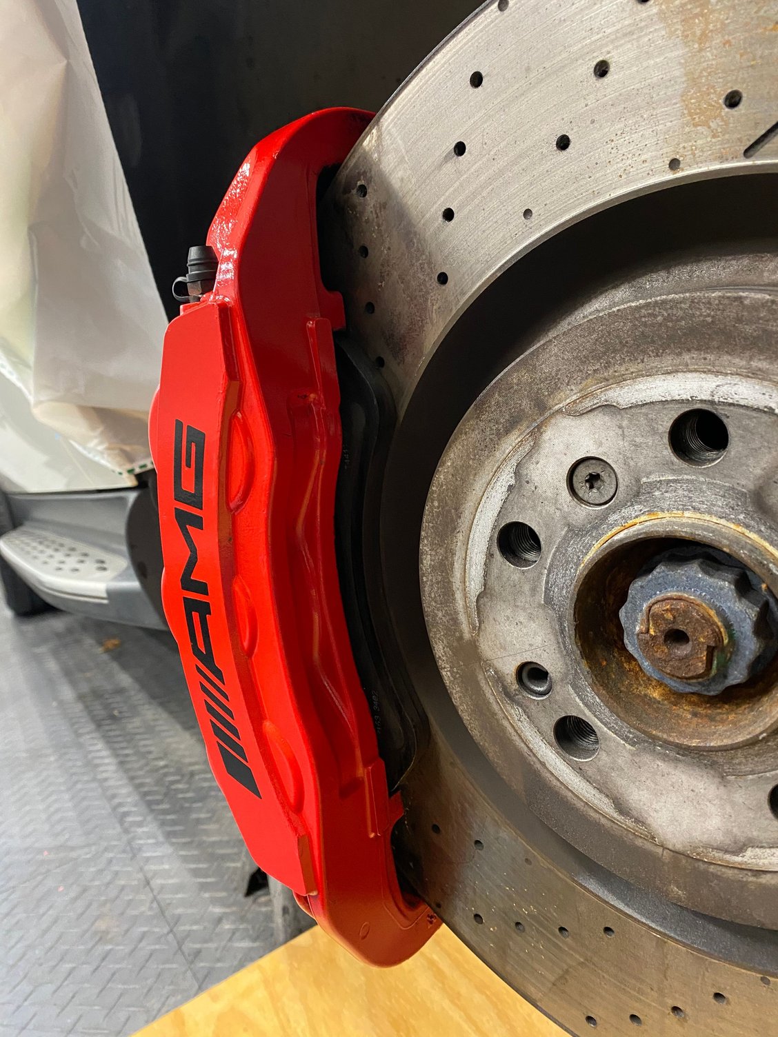

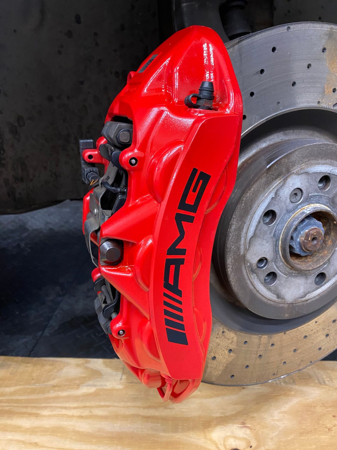

After a few coats here are the results! 4-5 coats each side is plenty.
All the paint cracks and chips are gone!

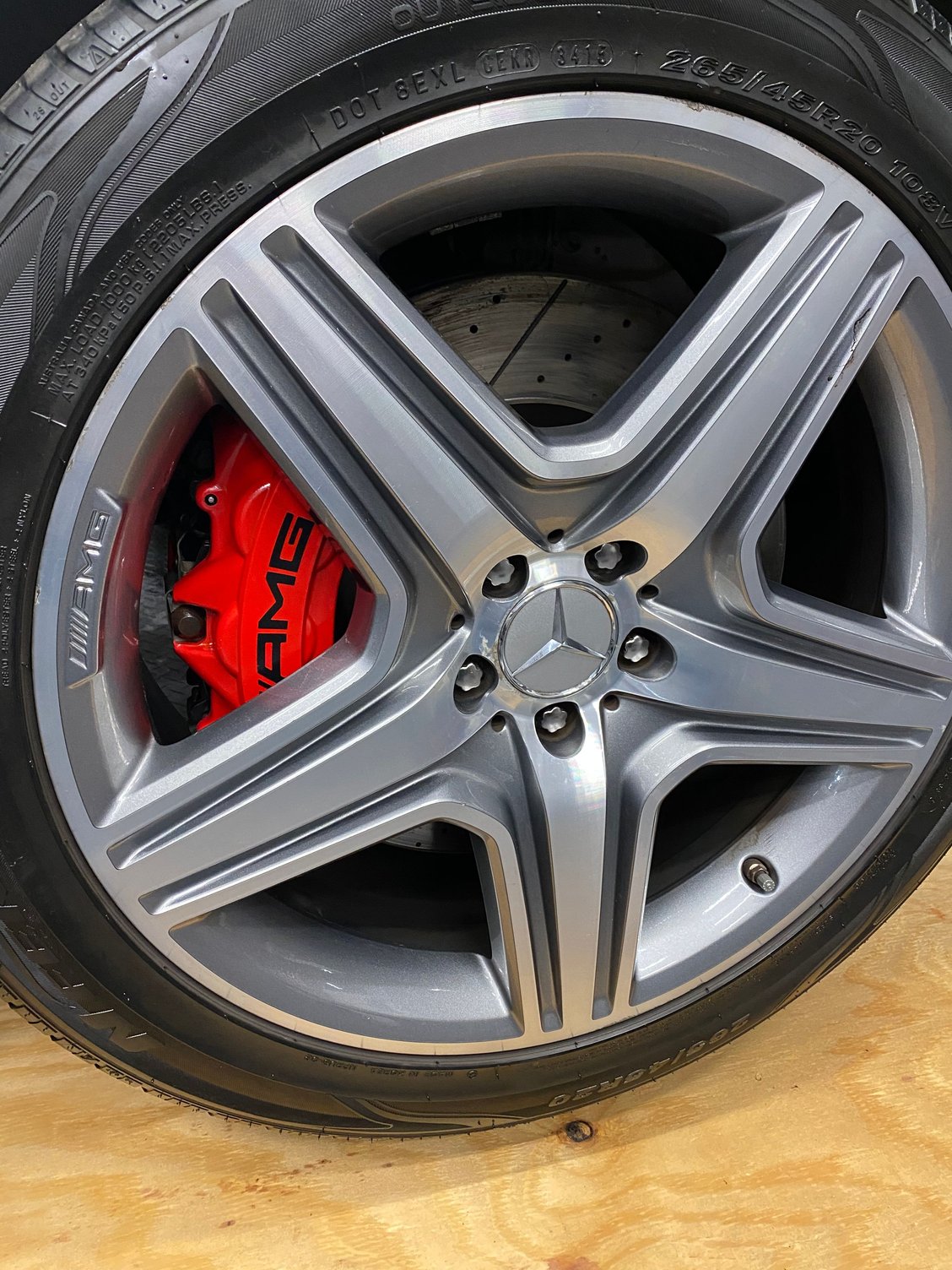

They look great behind the OEM AMG 20”s!
