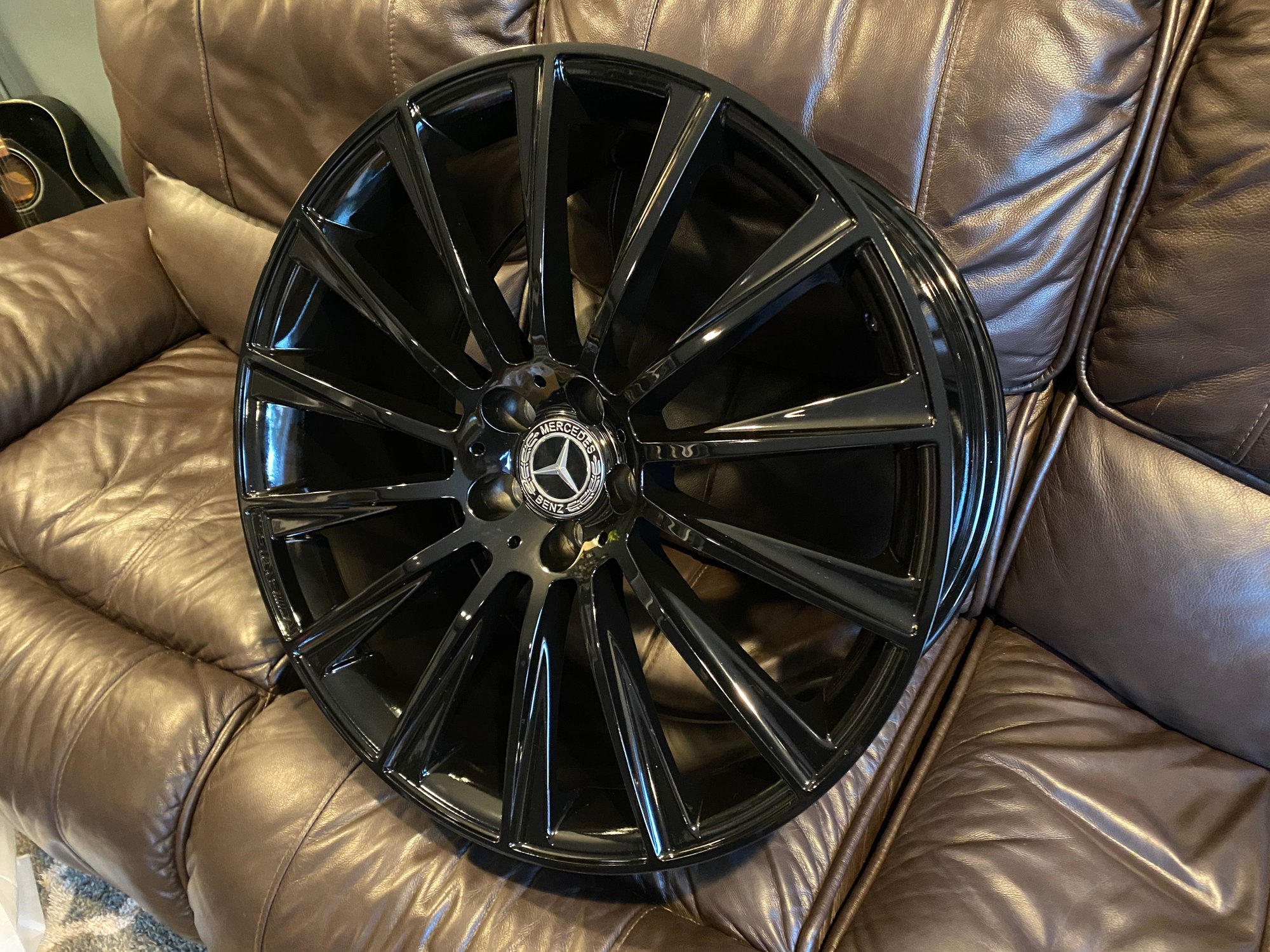

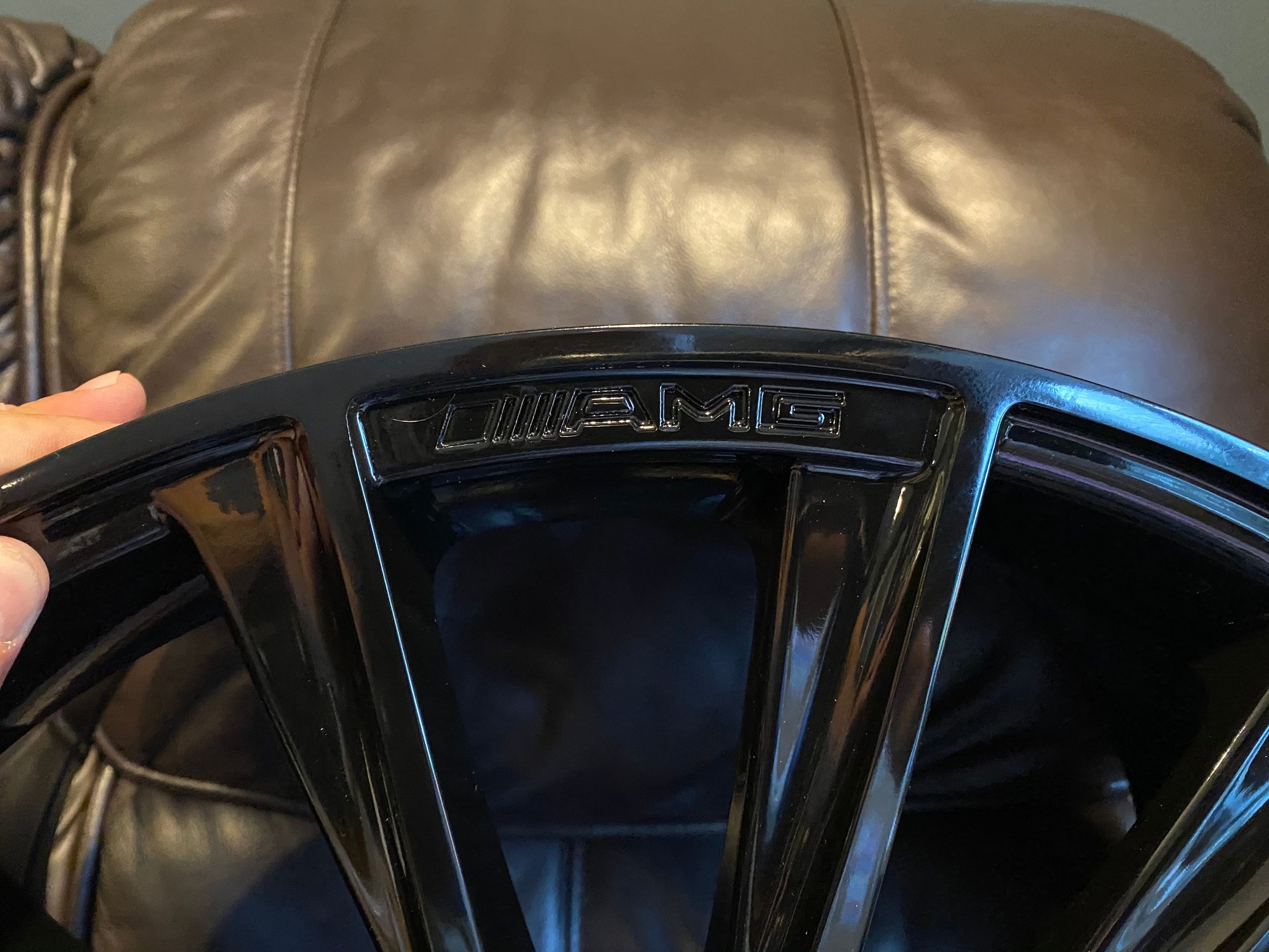

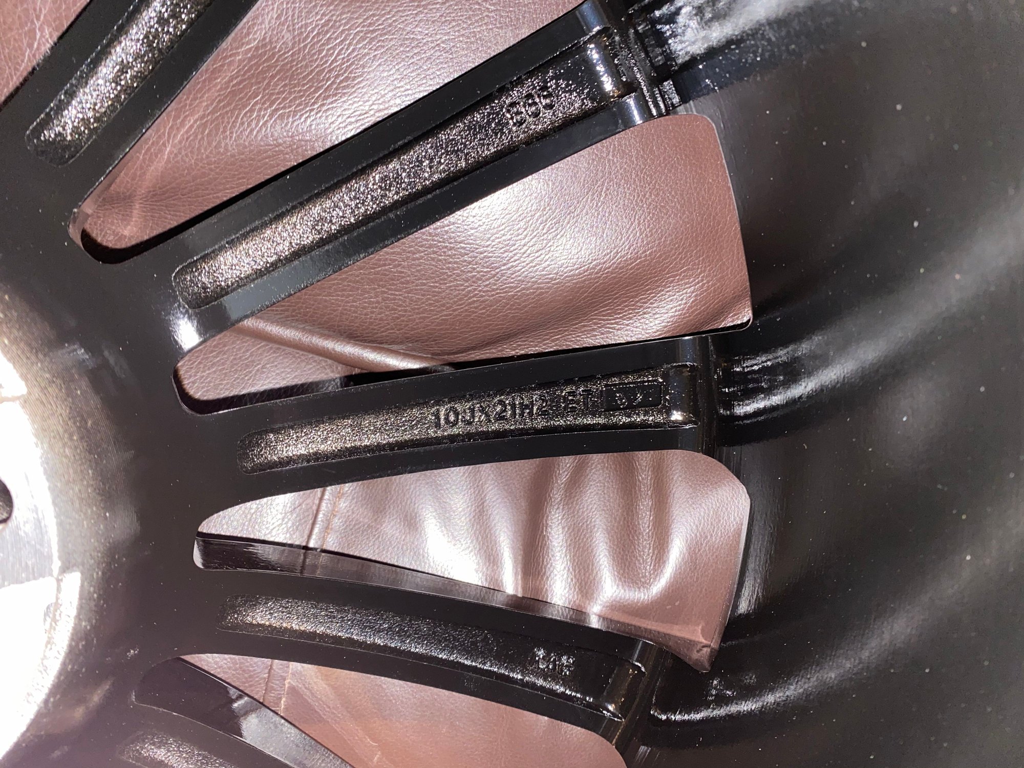

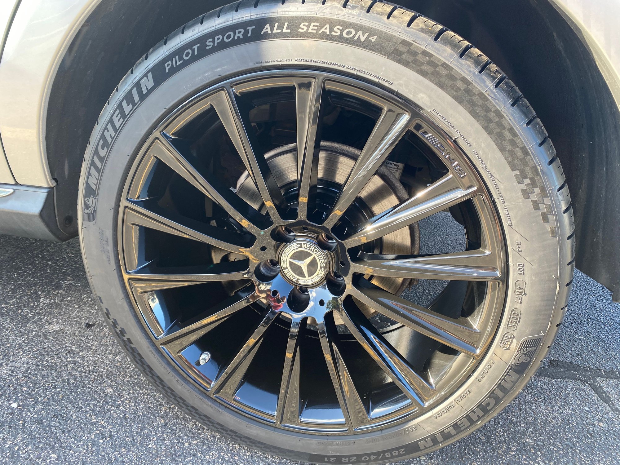

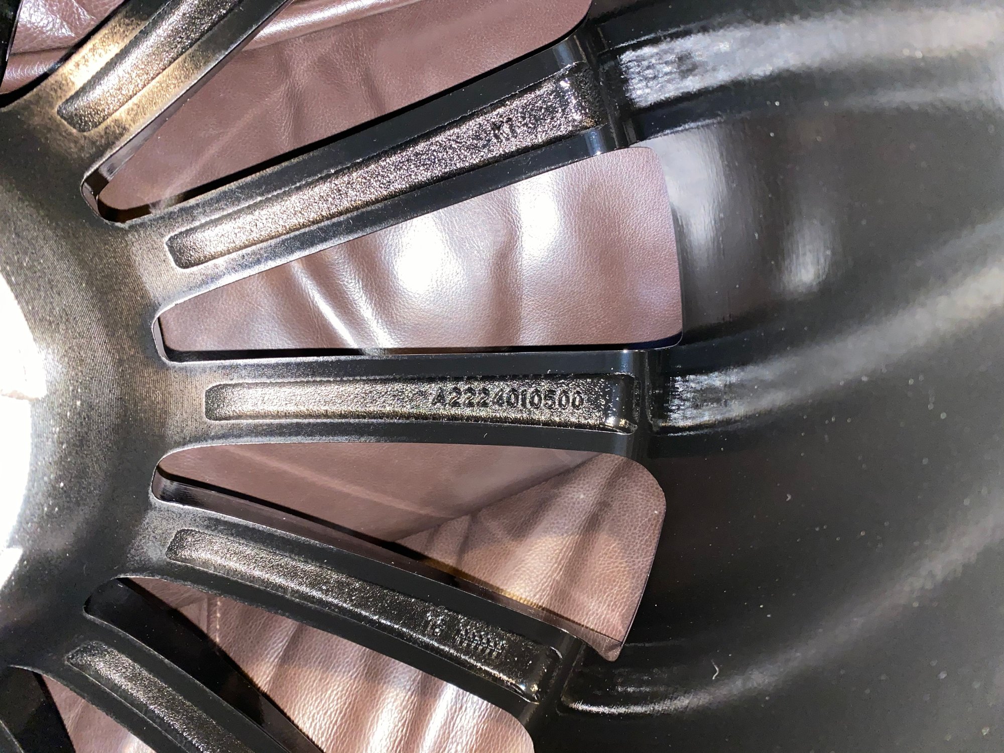

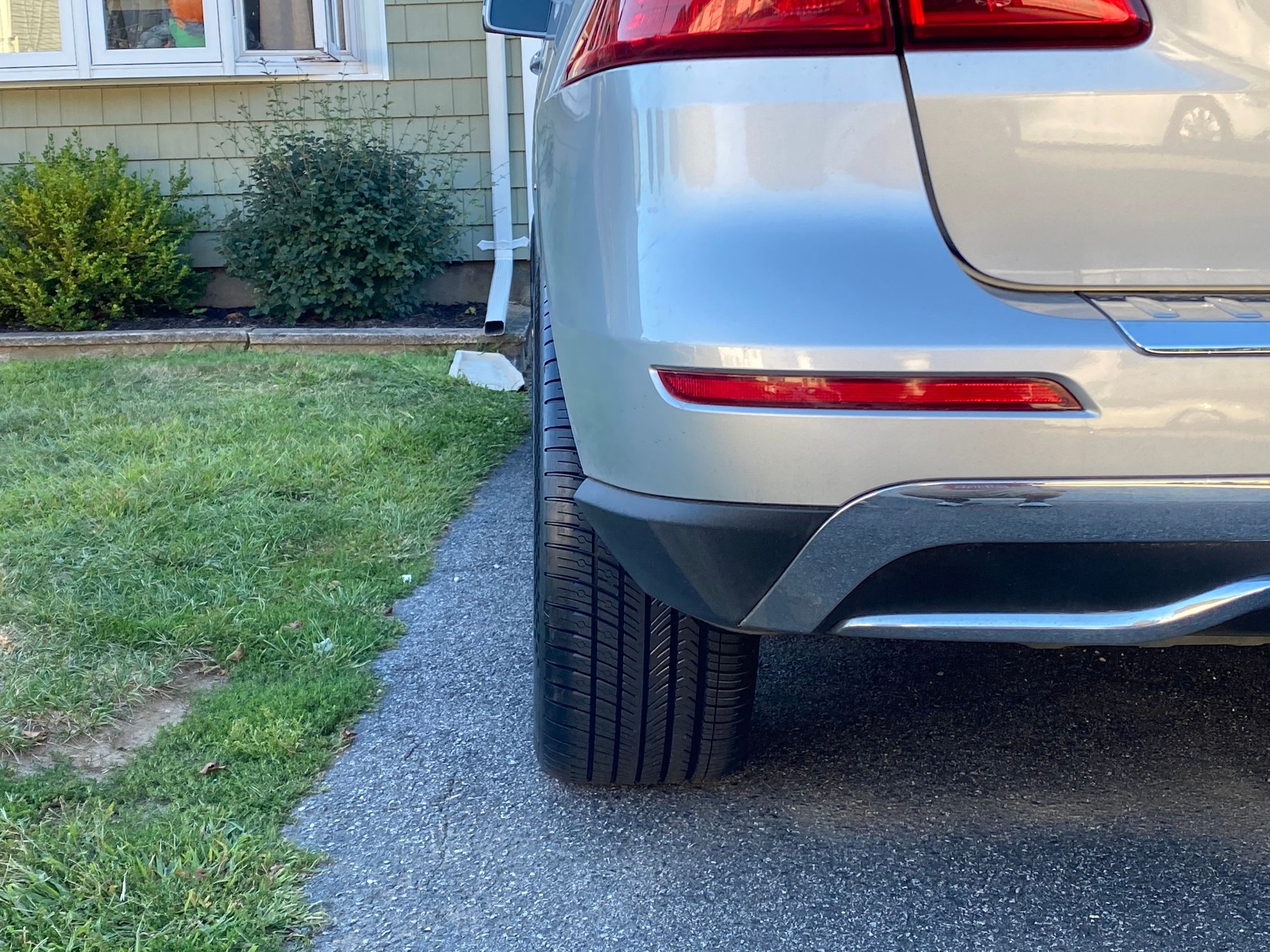

so this is my first post but as a new Benz owner I’m sure I’ll be poking around here a bit. 2012 ML 80k super clean in and out pretty well loaded (blind spots, lane departure, etc). Brand new pads and rotors all around done at dealer, had the entire vehicle checked after purchase...all it needed was front sway bar links which I had replaced, and alignment. I just put on these 2020 AMG 21x10 gloss black wheels. Offset +46. Tires are Michelin Pilot Sport A/S size 285/40r21. Also had the rotors and calipers painted black just to clean up behind the wheels. I know people are always looking for pics and wheel sizes, so here’s a few for reference! I think it looks really nice and changes the whole look of the SUV, handles better and still rides smooth takes bumps very well.

Personally I would prefer higher offsets of closer to ML63's et56 as the poke is noticeable, however as is the look is much better than stock's.

I like the wide stance.
