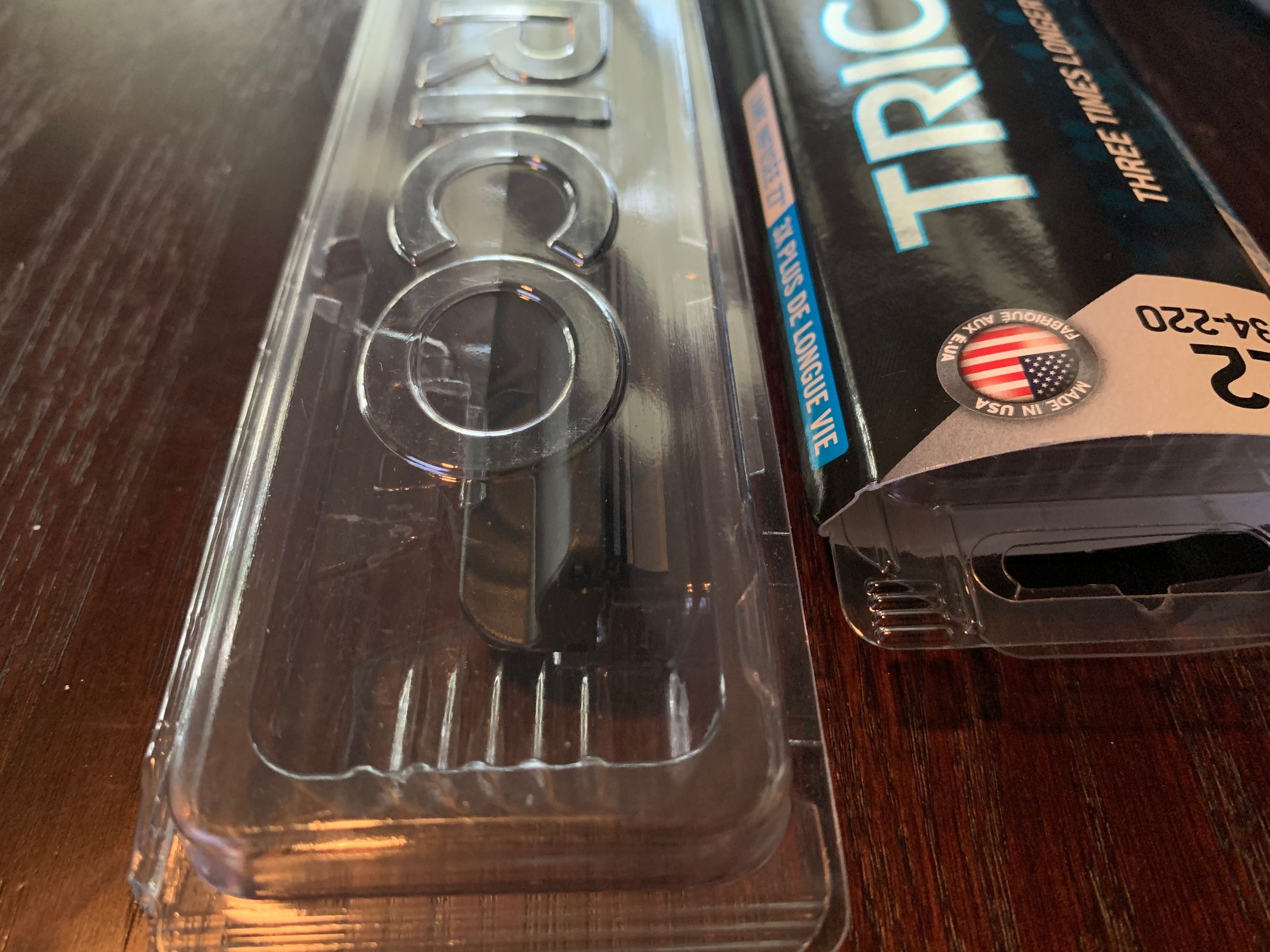

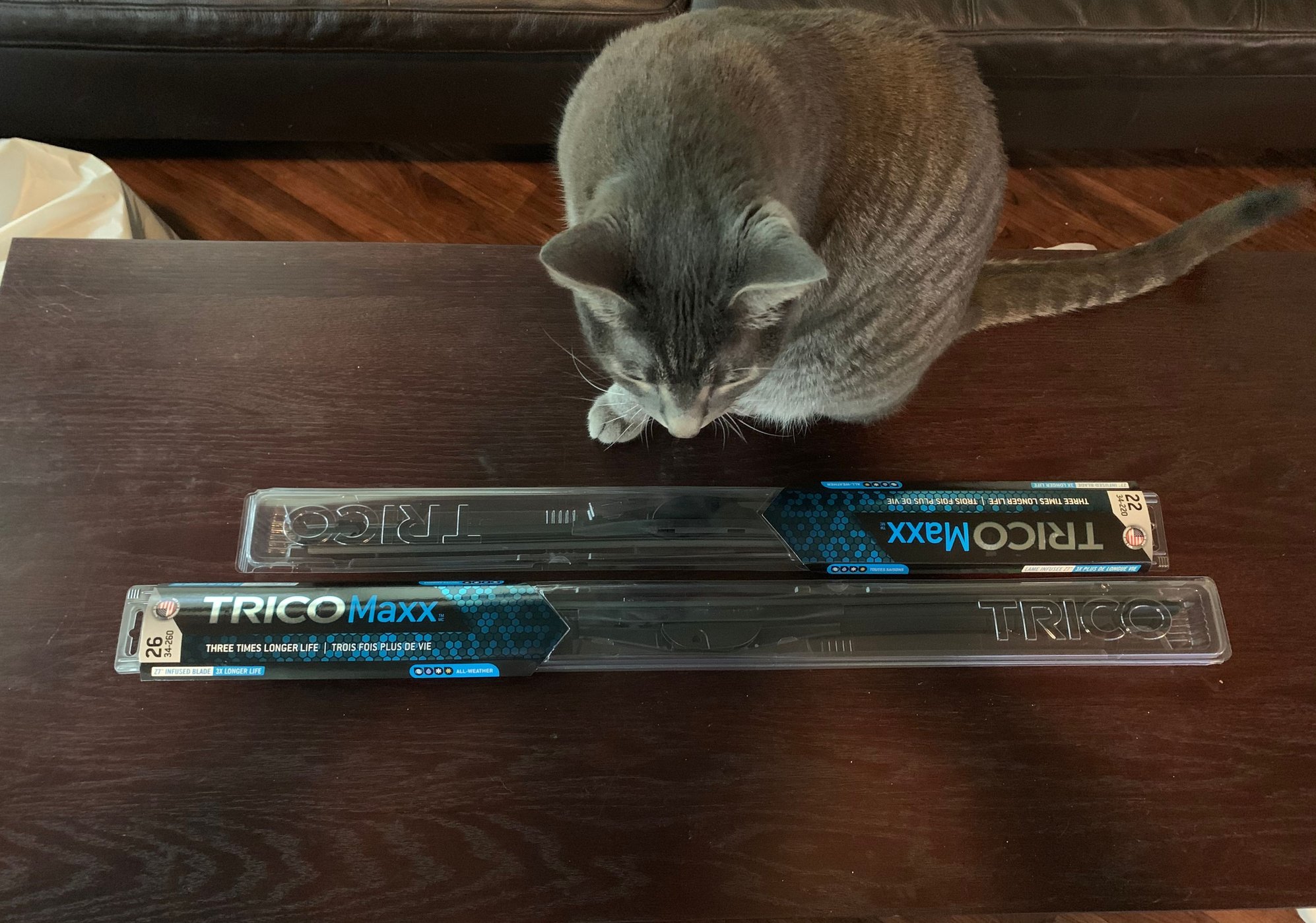

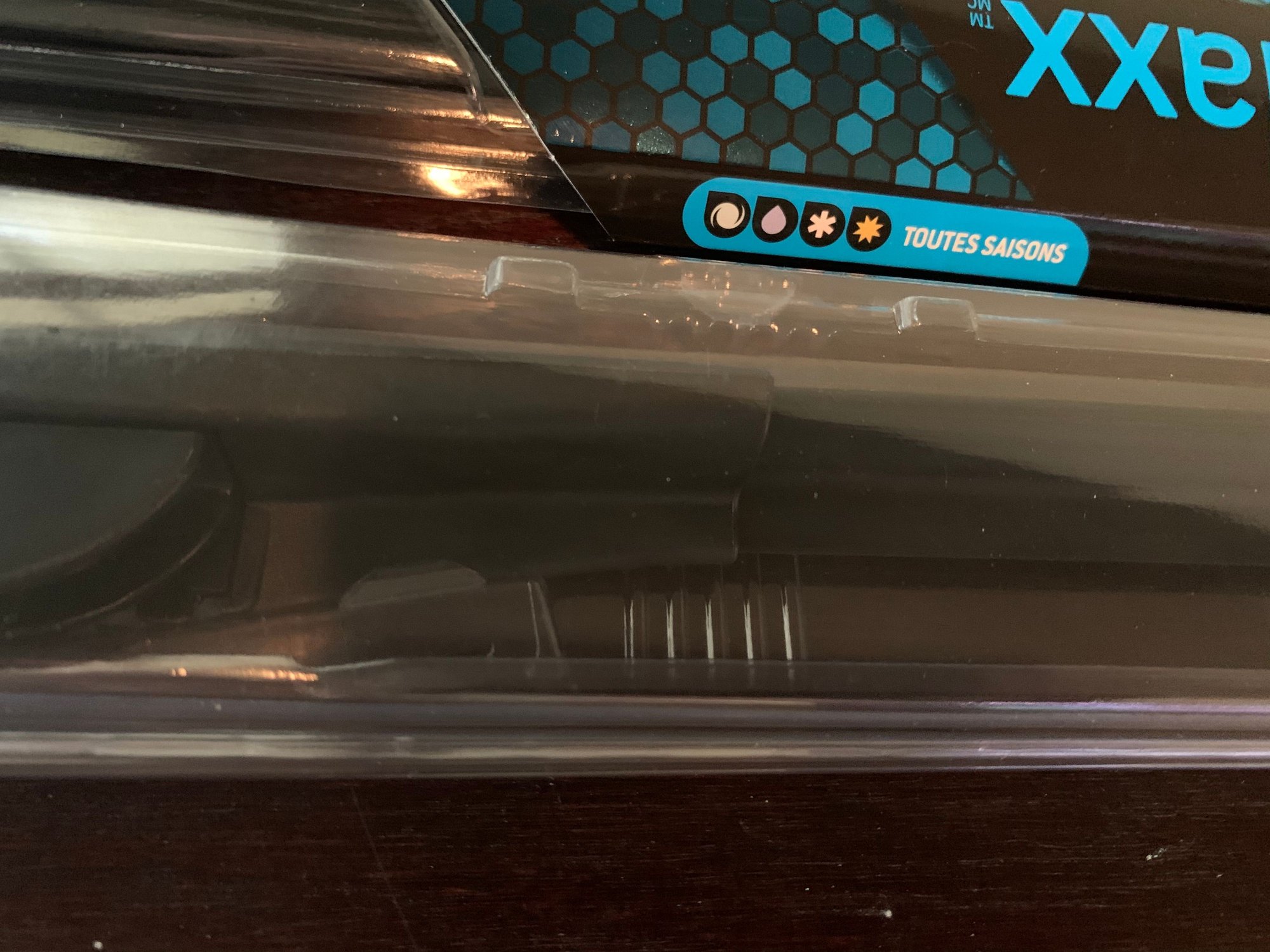

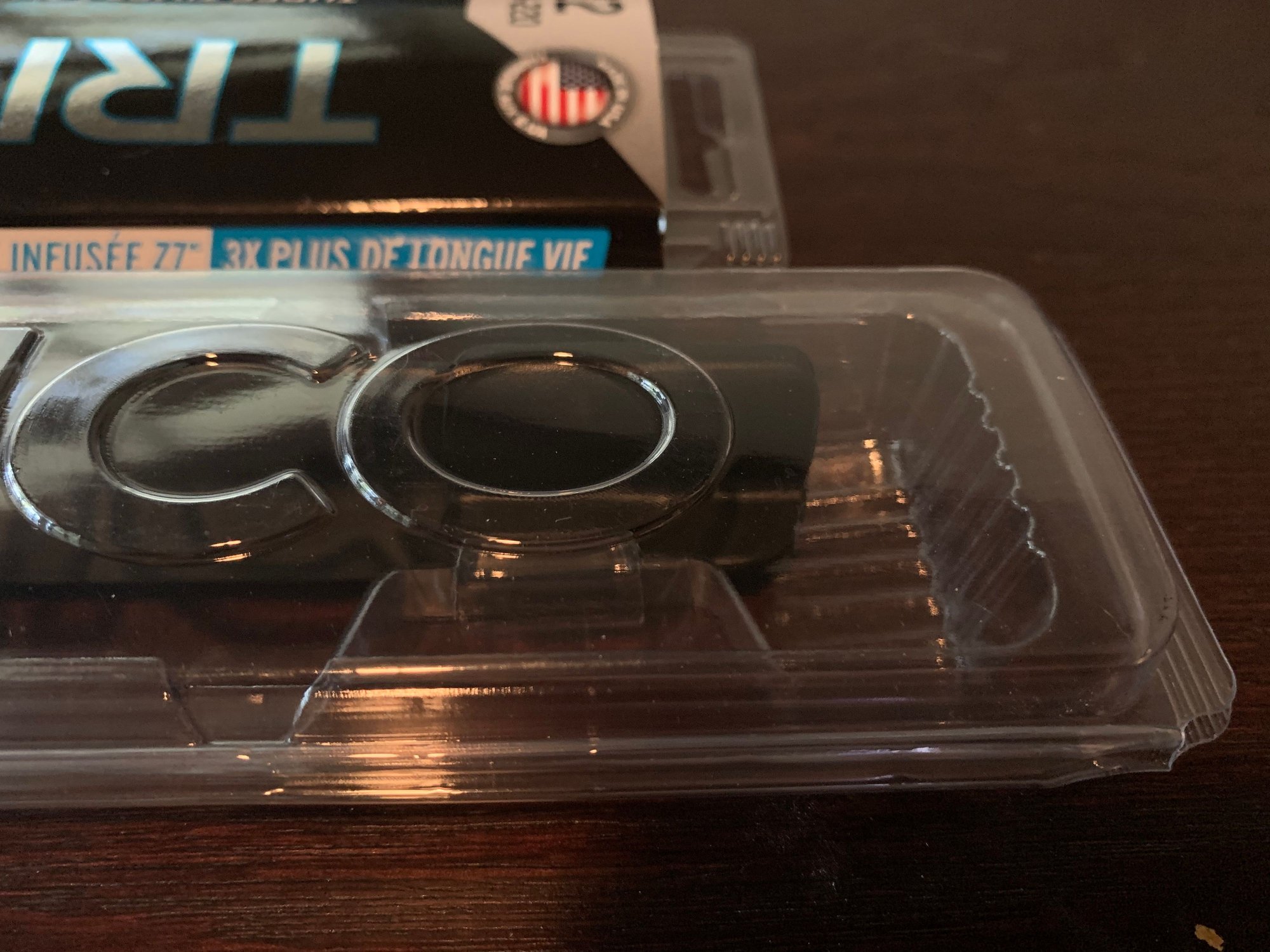

Spare wipers with shop supervisor inspecting the parts.
End reinforcement profile.
Side profile.
Arm interface reinforcement.
