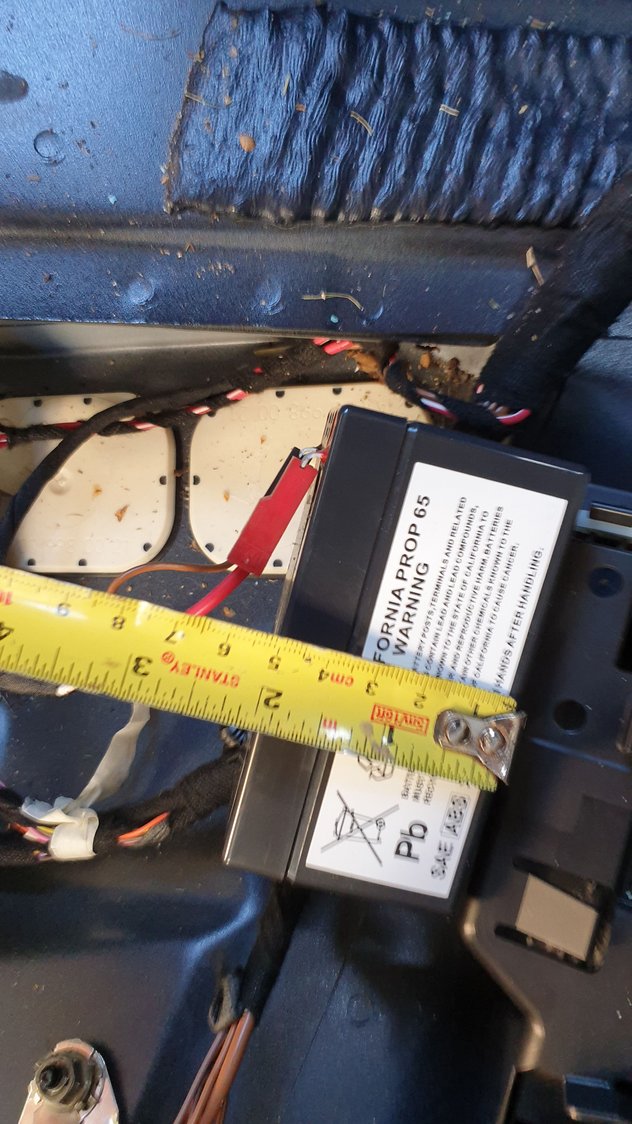

Thought I'd post this for you all just for reference.
I've read so many threads about the location of the Auxiliary battery in the GLE350. I have a 2016 GLE350 Diesel and am in the UK.
The car has air suspension - one tank in the spare wheel well, and the other in the right hand rear of the boot/trunk.
See pics attached. The battery is very small.
The local MB dealer had none in stock, so i've opted for a Yuasa alternative. See the last picture.
It is located under the left hand rear seat in the car under the carpet. You will need to take out the folding seat section to get to it.
What a pain, and what a stupid place to put it.
I hope this is useful to somebody.
