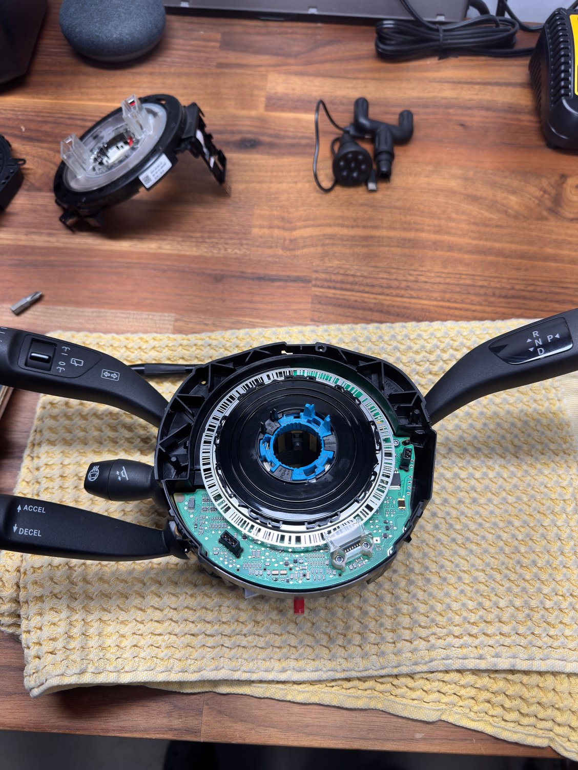

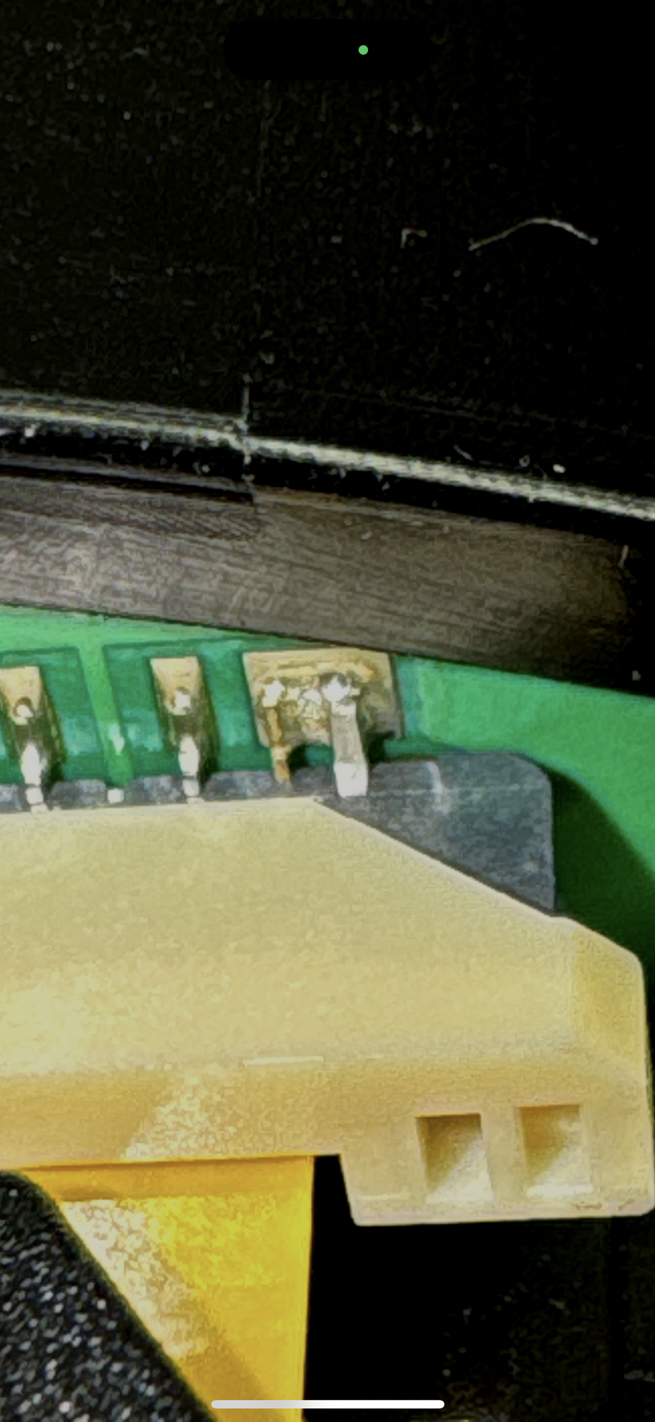

Here's an update 2 years later since I replaced both batteries. Shifter has started to act again, this time it went completely numb and I spend on Costco parking 10 min restarting everything. So I gave up and ordered SCM from scrap. Replacement took me 30 min - so far so good.
Attaching photo of original module - seems like serial problem with factory soldering.
