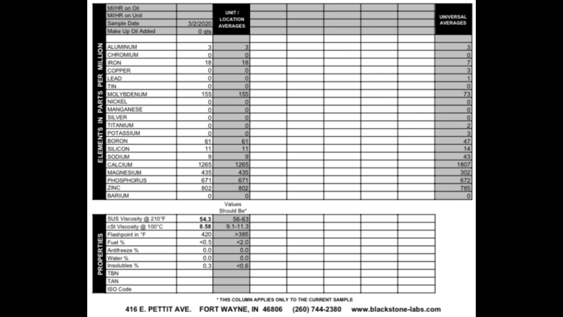

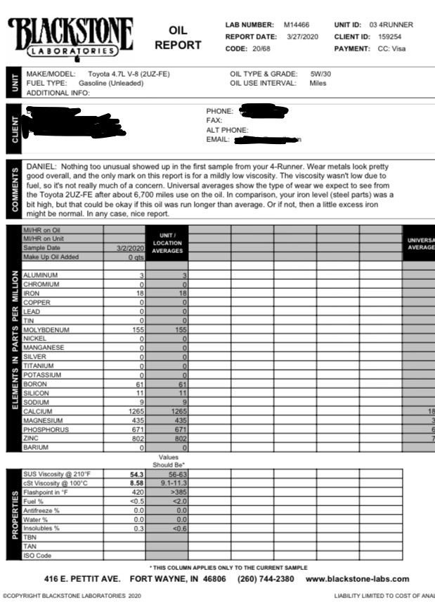

My oil analysis from my other car
Attached is my oil analysis from my 2003 Toyota 4Runner which had over 100,000 miles on the K&N air filter and around 213,000 miles on the engine at the time this was done. The car has well over 222,000 miles on the original motor at this point as I speak. I never had any issues with the MAF sensors on any of the three cars which had a K&N air filter. I am getting a new filter for it because its too dirty. I will do my ML350 oil analysis next. Any of you care to post your results?

Useless report. As you do not note or state how many miles that oil as seen before you sent the sample in. For all we know that's oil has only seen 500 miles.

No one cares about the UOA from your other car. Besides, a UOA only tells you how much life the oil has left in it. It is no more relevant to the topic at hand than the expiry date on the milk carton in my fridge. Why are you still trolling?
