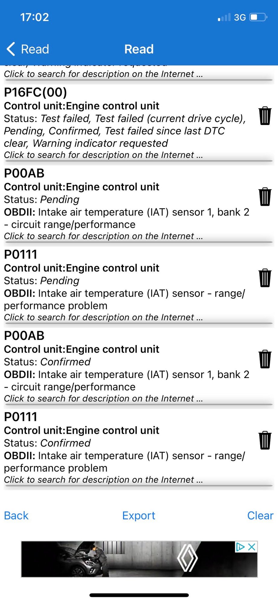

Need Help‼️So some time ago I had MAF engine code light on. I did purchased German after market y shape pipe with two sensors. The MAF code disappeared but the Intake air temperature (IAT) light is on. My mechanic friend checks all the wires all seem to look good. The strange thing is 3 mechanics that work with Mercedes cars said the IAT sensor is integrated with the MAF sensor and because the part is not from Mercedes the IAT lights are on. On the other hand, he called Mercedes to find out where the sensor is located he did found one after unplugging the sensor it did shoot a completely different code. (seems that the sensor it's not a problem) any ideas?? It's a w166 bluetec 2014 350

Yes, after swapping to the old MAF the IAT problem is gone. Somehow after changing air filters and cleaning MAF the old one started to work. Now I have returned my NEW MAF so £250 saved. The shop didn't even asked questions so I assume that they knew that their part have problems.
