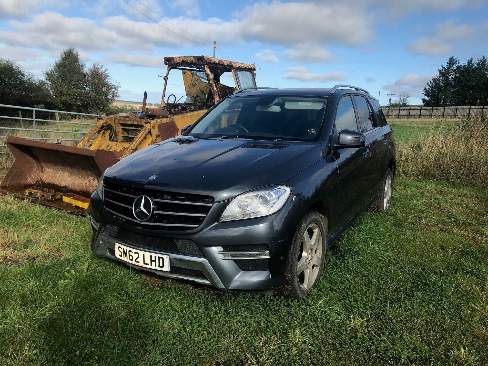

My ML250 has been laid up since the start of the pandemic whereby I had just serviced it. It had also just had a new battery installed, walked out to it one morning and completely dead, changing the battery was a bit of a task with no power. Anyway, the EML light came on not long after and the codes thrown up were;
P0685-The output for Relay Circuit 87 has an electrical fault on an open circuit
P20BD1B - The output for heating element of the adblue tank has an electrical fault on an open circuit.
I can manage the mechanical recommissioning, brakes, servicing, new batteries, auxiliary included but have no idea what Circuit 87 and feel like i'm likely going to need a new adblue heater, I have seen the XeModeX replacement which is more attractive price wise than the Bosch unit from MB.
I suspect something took a surge when I connected the battery in 2020, the replacement battery is also dead, any suggestions as to how to approach the electrical issues, any help would be much appreciated.

2012 registered ML250 affectionately known as Sherman, US built and feels the size of a tank on UK roads
