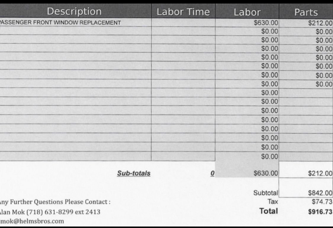

So my Benz got broken into and my front passenger side window was broken. I contacted Geico for a replacement and they were quick to offer a free cheap replacement window from Safelite but refused to pay for an OEM part. I declined and bought an OEM glass from the dealer myself because I planned on getting the windows tinted, wanted all windows to match, and wanted quality glass.
Please shop around for the OEM glass because prices vary by dealership. One was charging 290, another 250, and one was 212. Obviously I went with the cheapest one because why not.
The stealership quoted me..get this, $916!
Said no thank you and opted to look elsewhere. Other locations charged anywhere from 60 to install it to $590.

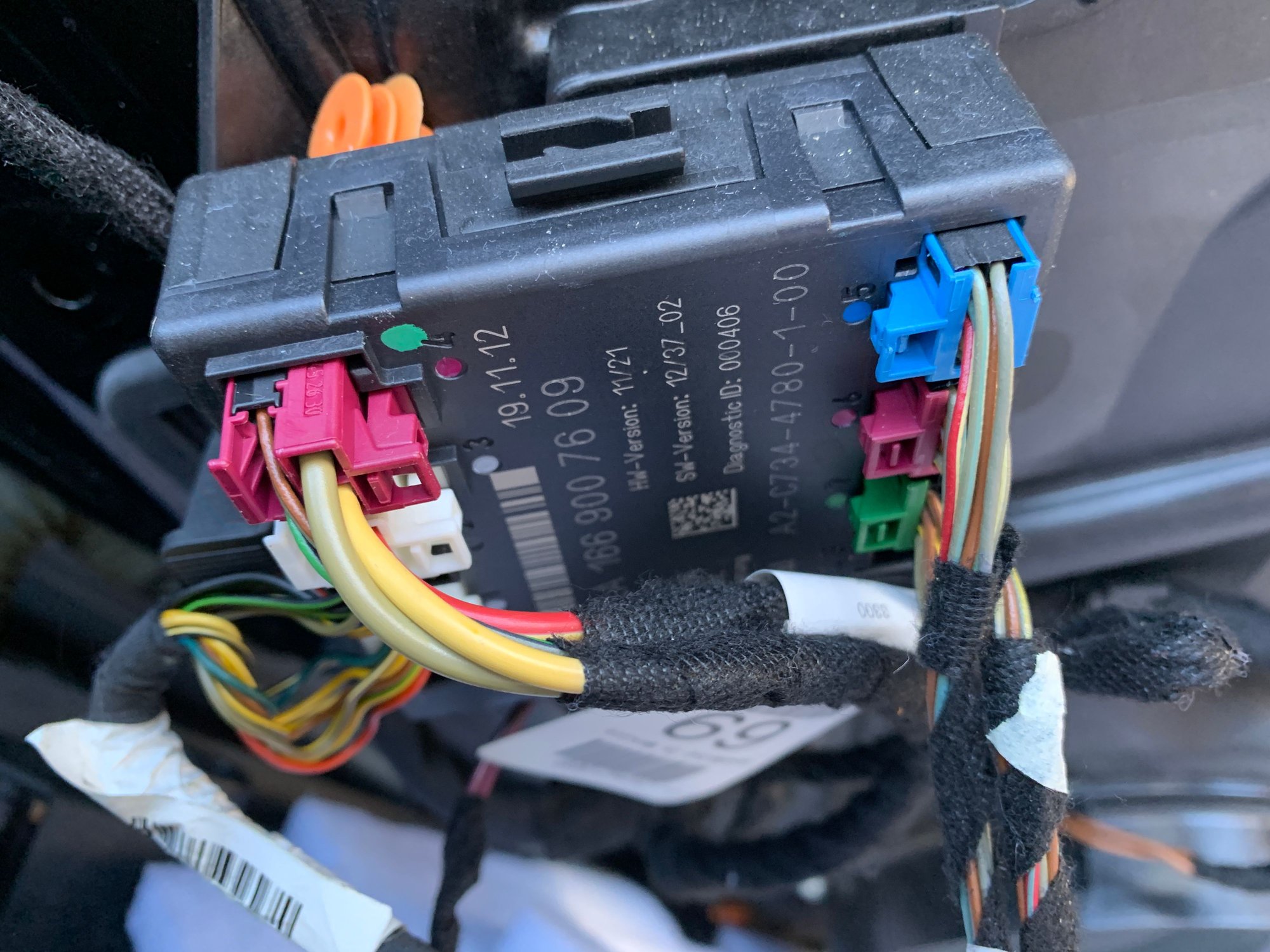

7. Now with the glass panel removed or the empty/broken glass filled mounts loosened, it’s time to remove the panel. I recommended taking a picture of the connectors before disconnecting anything on the door. Use that 2-3ft box to support the door while you remove the connections on the door trim panel.

Connection orientation
Stealership repair quote
