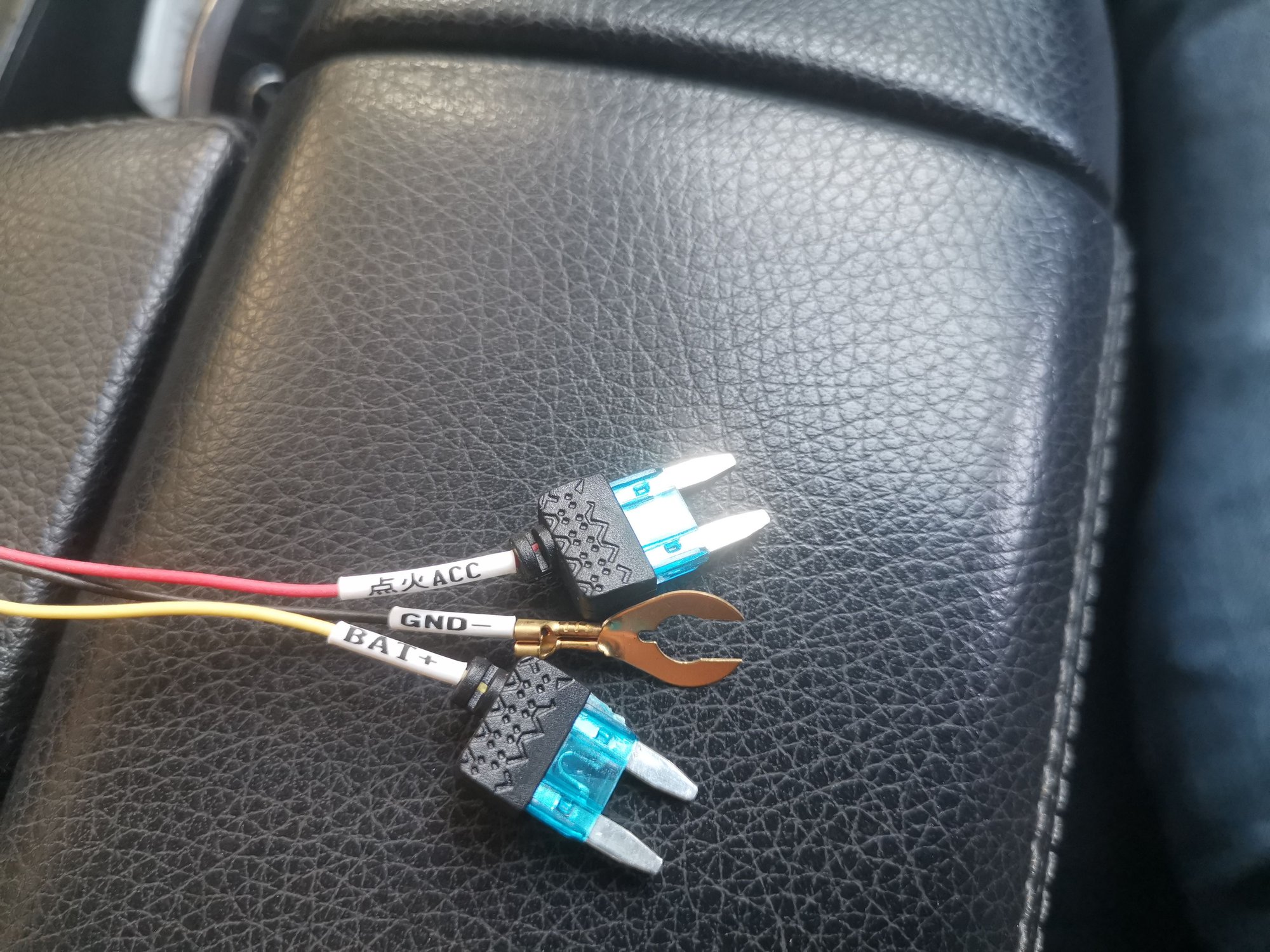

I have a 2012 ML350 and have just attached a front and rear dashcams with 3 wires I need to connect, Battery, Ground/Earth and Accessories.
Any suggestions on where to connect them, the battery and accessory ones are wired up to what looks like a std fuse, the earth wire is just a plain horseshoe shaped brass. I'm assuming the two with fuses are designed to go into a fusebox but which one?

Most convenient would be the passenger side dashboard fusebox, I don't think you will truly find an ACC connection there. I would make sure your dashcam has an auto-shutoff feature. Also, ML's use full-size fuses so those connections won't work.
https://www.mercedesmedic.com/fuse-m...00-550-63-amg/
