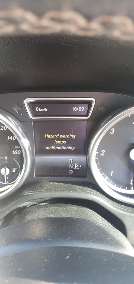

Hi message on dash saying ' hazard lamp malfunctioning' also the buttons on the same panel are not working. New to all this so any help much appreciated 🙏
One small wire is out but not sure where this should go, is this the reason hazards arent working ?

All sorted it was a fuse once a investigated where everything was
