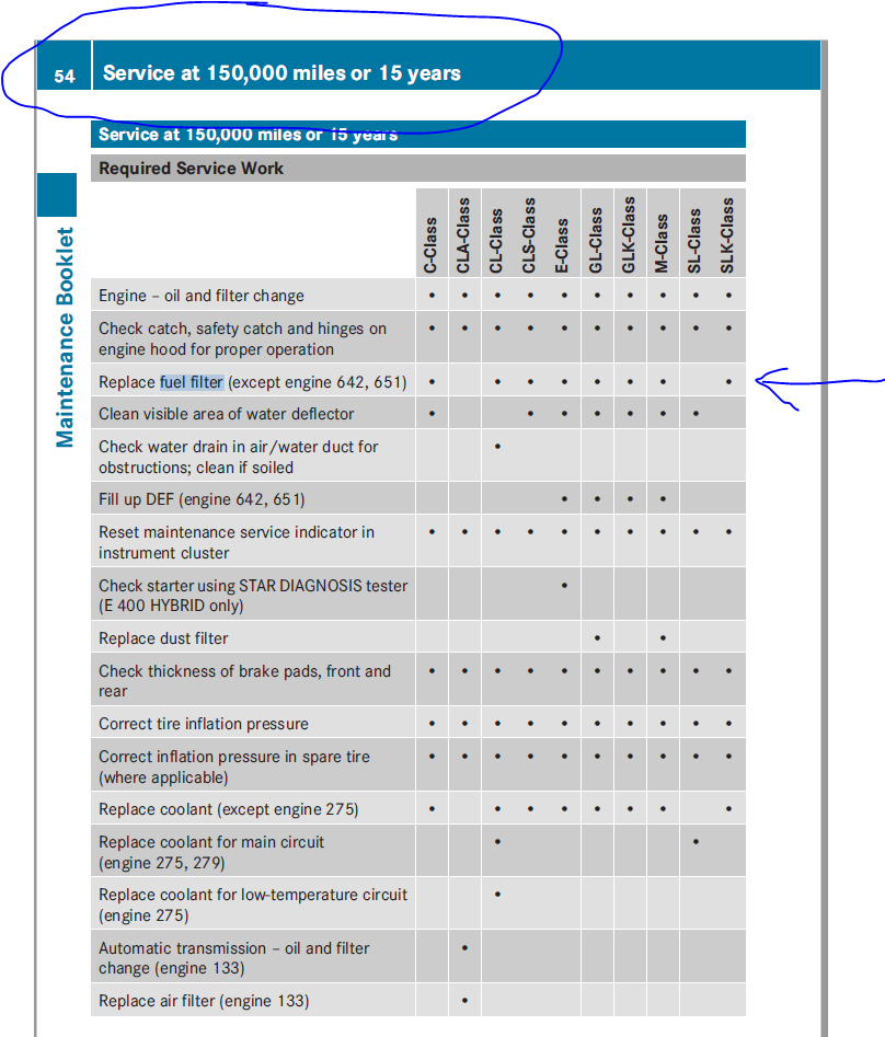

Here is the official written recommendation from MB
As you can see in my signature, the W211 already passed 150K miles, and the fuel filter definitely failed (stranded) as expected like clockwork @150K miles. The 2012 ML350 passed 120K miles and it is running just fine w/o fuel filter issues (yet). The 2015 ML 350 (new to us) has not been done @87K and the 2014 E350 @96K miles and no signs get. Fingers crossed the 3 of them last up 150K.
