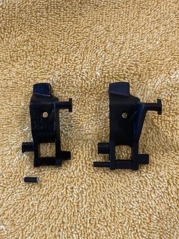

Looks like this is a common problem. The part is available on Amazon or eBay for $12.
Watch the first video, and then the follow up video to see how to do it without removing the entire center console.
Also, you can leave the USB and phone connectors in place and pass that panel through the hole when you remove the storage box.
Good luck!

Image of broken part and replacement
The pin that holds the spring in place broke.
