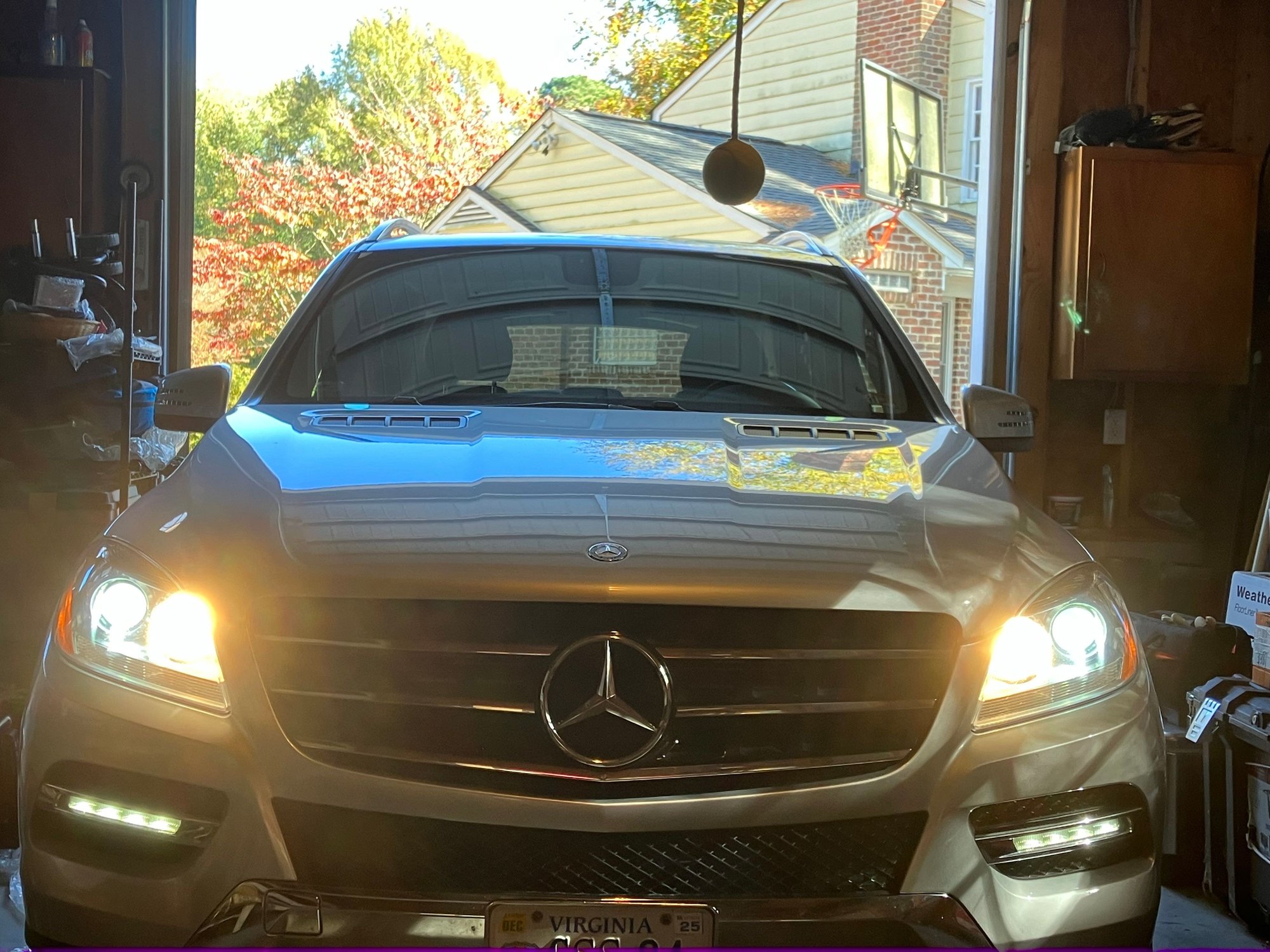

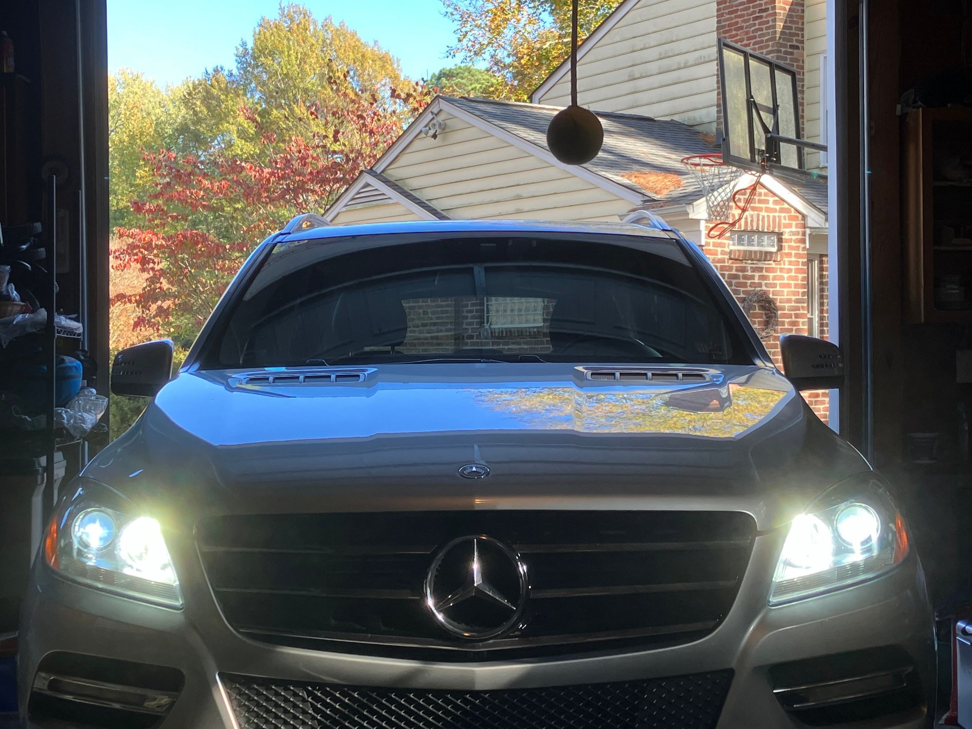

New Lasfit Custom Pro-MB2 H7 LEDs
Low beams with new leds
Low and high beams with leds
Thank you, Isaac2021-
i just installed the Lasfit Custom Pro-MB2 H7 LEDs in my low beams and they are a dramatic improvement over the original halogens. Amazon price $79.99 with discount and $10 coupon.
I started with the left side and it took about forty-five minutes with an adjustable wrench to loosen the original bulb and retainer. After gaining experience with the left, the right side took maybe five minutes. Perfect fit and light pattern for my 2012 ML350 4Matic! I may have to replace the high beams since they look so yellow in comparison.
Thanks for the tip…I now feel a lot more comfortable driving at night.
