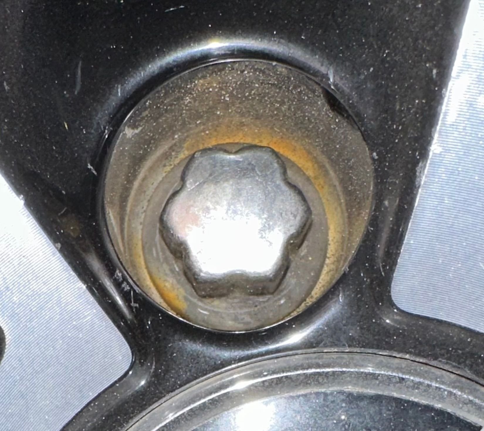

The dealership didn’t give me the lug key. What do I need for these?

Flower socket.

I can’t find it on Amazon. Can you send me a link and what size?

This should be the right size.
Amazon.com: ATLIN Protective Lug Nut Socket for Mercedes Vehicles with 17mm Convex, Flower Head Lug Nuts : Automotive Amazon.com: ATLIN Protective Lug Nut Socket for Mercedes Vehicles with 17mm Convex, Flower Head Lug Nuts : Automotive

That's the one I have and just to confirm...it works great on the flower head bolt heads.

The socket arrrived and it won’t really fit. It’s snug but won’t full seat over the bolt head. Did I get wrong size?

Could be because someone incorrectly used a 'regular' socket and rounded off the points of the flower.
