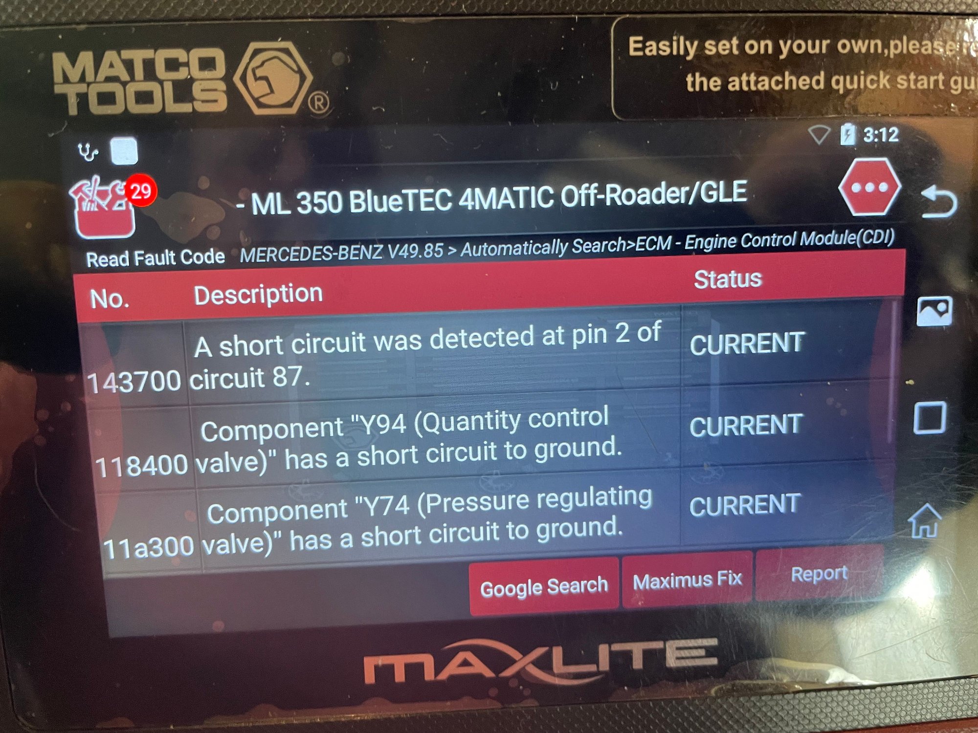

New info, used a different scanner N74 and N94 codes pressure and quantity valves show a short from positive to ground so I disconnected them. Now the transfer pump works and the two valves show an open circuit. Checked the resistance of the valves-3 ohms across the coil. Checked each side to ground no reading so I assume no short. Tested with 12 volts and I can hear the valve click open. Can anyone tell me how the ECU determines it has a short?
