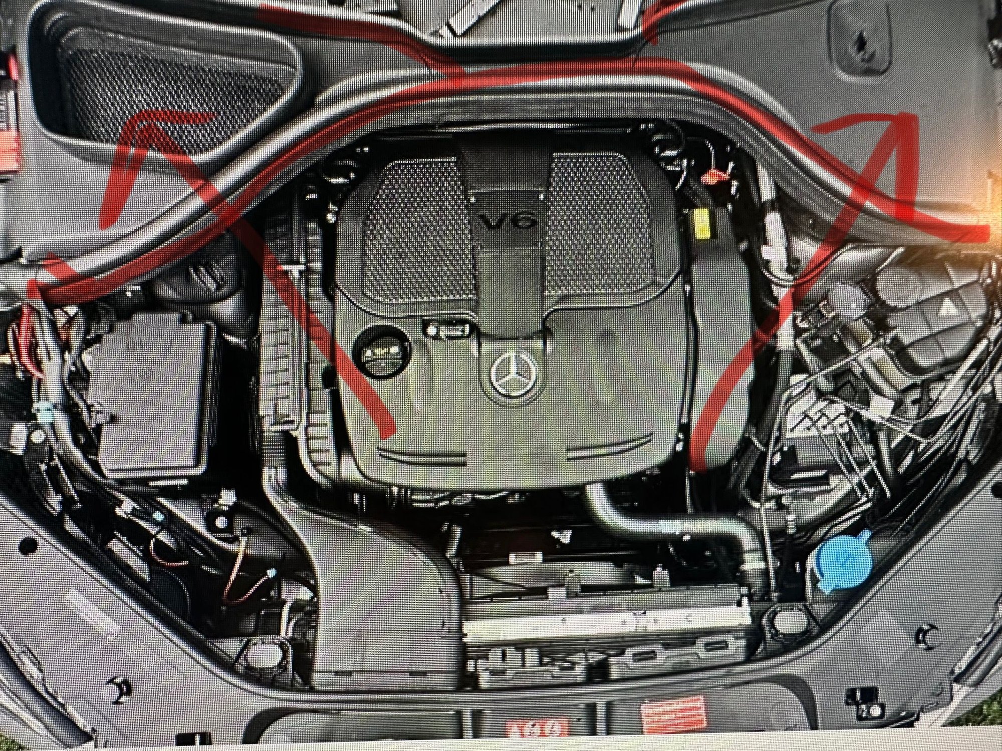

I bought a 2015 ML350 Base and didn't realize that the two plastic fire wall covers behind the motor where missing. Anyone know what there called and possible part numbers. Thanks in advance

Engine panels?

engine bra...kidding. you need to get those or water will be splashing everywhere in that area and it might find it's way inside the cabin.
There is also sound insulating material that is good to have.

Driver side is called "cover" part # 166-831-00-41
Passenger side is called "Air Inlet" part # 166-830-02-01
