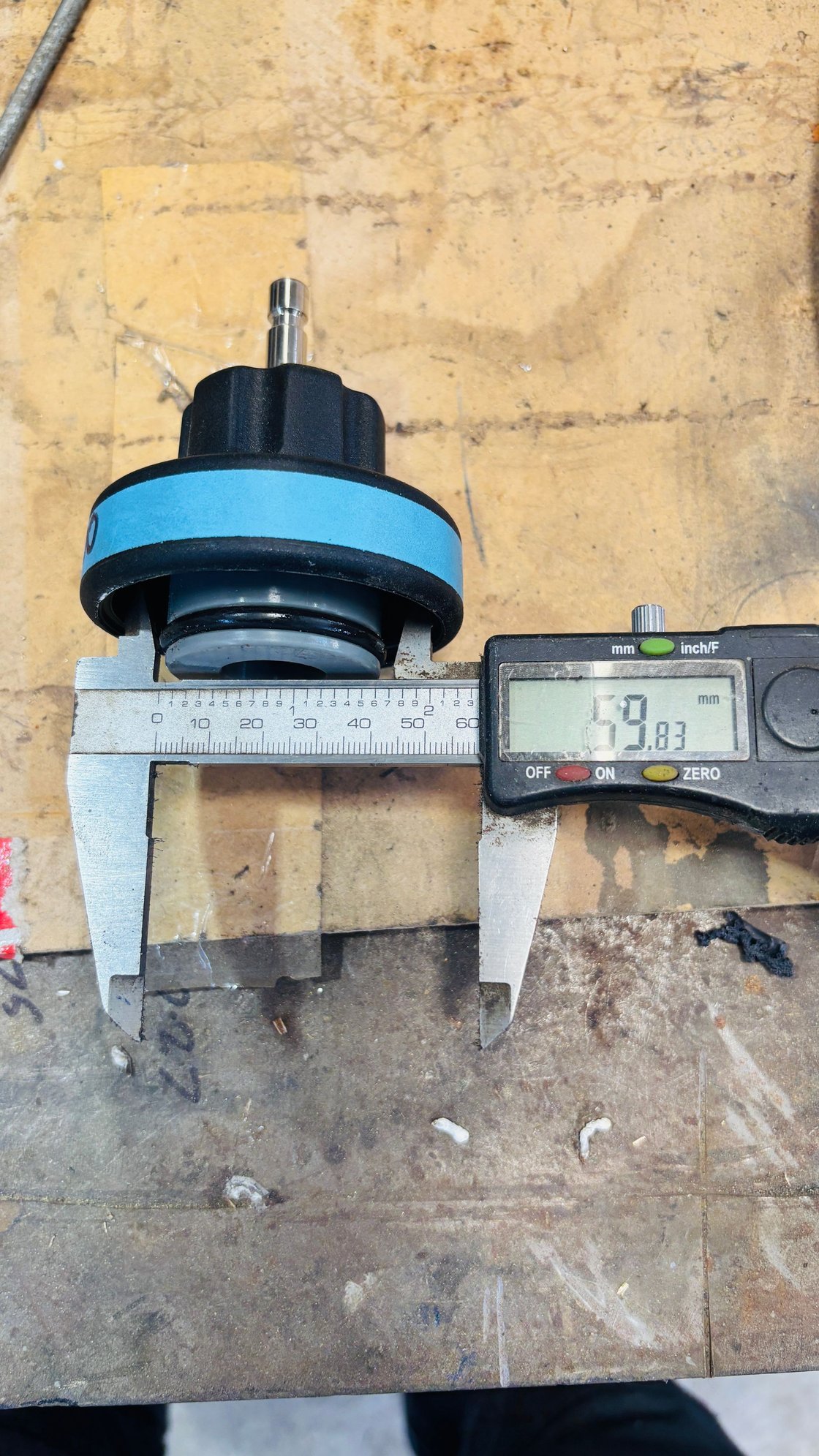

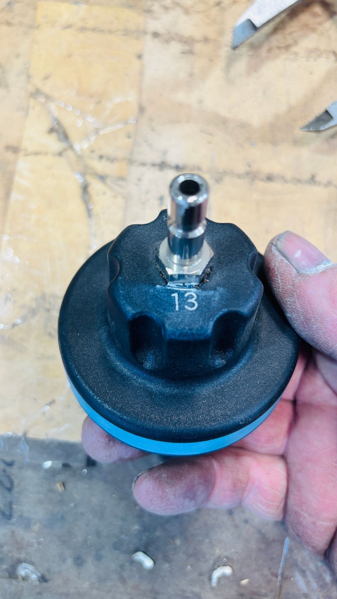

For the ML
Internal plug
Internal plug
Inside thread size
Inside thread size
Number 13 in the Toledo pressure testing kit.

Thanks a lot for all these measurements!
I ordered initially this kit on
Amazon Amazon
and on this one, adapter 13 is the one that fits, but I am unable to create any pressure with the pump.
