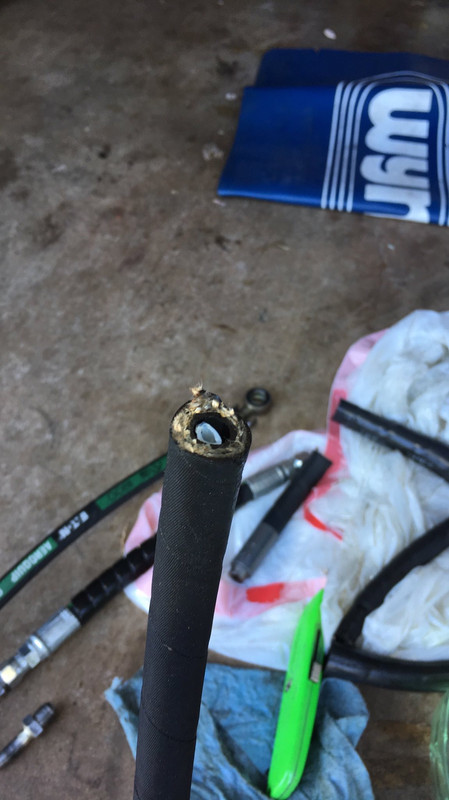

I just got done replacing a number of hoses in the ABC system.
The particular hose that broke goes off the pump and into nothing: thus supposedly acting as an accumulator. The hose is NOT a traditional steel braided rubber hose but is instead a fiber hose with a plastic center. I found this unusual as other hoses in the system are traditional steel braided rubber, however upon doing further research I found fiber reinforced hoses with a plastic core can act as accumulators/pulsation dampeners.

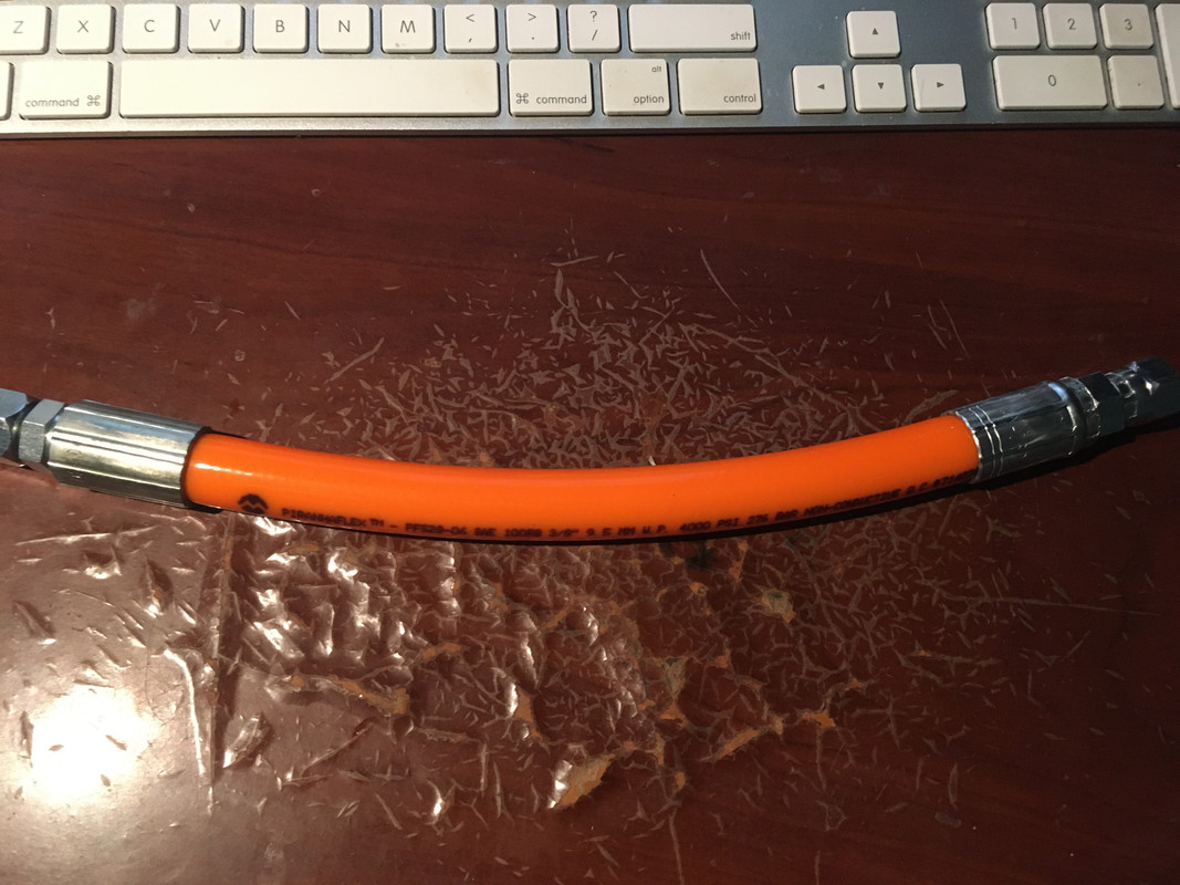

I'd like to provide an addendum to this:
Images of the cut original hose (that exploded), and the new thermoplastic fiber hose my hydraulic shop made for me:
https://postimg.cc/sB0FNVS4
https://postimg.cc/gXX99fHF

Want to make a real improvement? Run a hose to an accumulator. This will quiet down the pump... Though it will need to be one of small volume as all pressurized oil will return to the reservoir once the engine is turned off. Look to what MB did for 221 and 222 cars as a guide.
